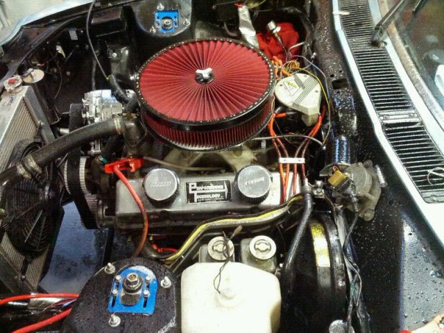

  4. Before the firebal some dailing in to do and check the 5 and 7 plugwire
  5. Better angle I bought two big ass fire extinguisher of a heli pad yesterday

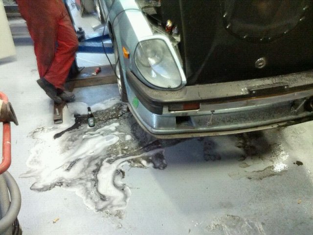

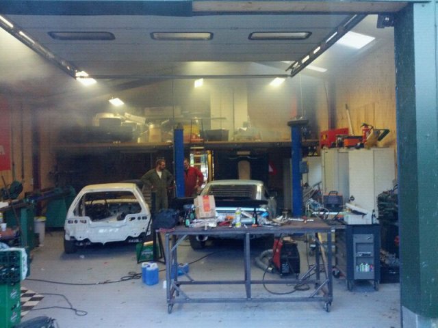

  8. Haha well hè ran for an extiguisher as was Mart the other dude filming outside.. Ill upload some more fotage once i have it. I switched the car off and pulled the pin on my cars fire extinguiser ran out to grab another. The car burned for no more than 20 seconds. I was very suprised not having more damage Full damege is: -2 wires of the wiper motor; -3 sensor wires of the dash that run to the brake reservoirs -2 plugwires -rash on the filter nothing that doesnt clean up. -melted wire sleeve at the ignition (cosmetic) This could have been really bad.. But then again im glad it happened like it did near big fire extinghuisers. Not testdriving! As for the v70.. A extinguisher that fits the glove box does not put out anything much larger than cigarette sadly.
  9. Sadly no onboard. We do have another movie showing hoe big the fireball was. On the upside it runs like champ. Minor details to finish before i can test 530 rwhp. Haha wel i can add some wires to fix and a cleanup. Apart from that i need steel braided oil Cooler lines and i need to reroute them. The new headers sit more angled away from the engine block, creating this carbq. Luckely it did not happen when driving!!!
  10. oooops luckely we have fire extinguishers. The damage are only 5 dash wires and 2 plug wires..

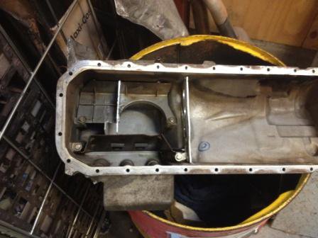

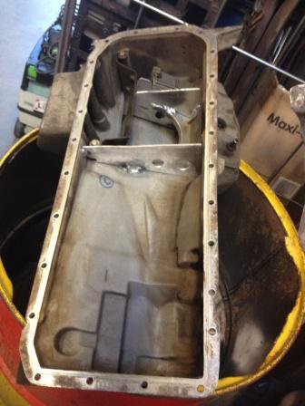

  12. I love this build !!! I run accusump aswel even if it is only peace of mind. My previous b30 sump I modified: Never had any problems with my oil pressure at all but they do need a sort of sling shot so i advice you to do that at least. It is also wise to use a group N oil restrictor s50b30's are known for having problems by pulling oil into the combustion chamber (when raced or under hard driving); Ill find the partnumber for you! You have to take the valve cover off. There is a hex screw in the middle of the head on the intake side that has to come out, and that's where you put it in. You have to unscrew the stud to get it in.butthats it! for a detailed discription http://zonemotorsport.co.uk/phpBB3/viewtopic.php?f=3&t=266&start=90 In order to place the airbox you have to measure the demension ( i can take them of mine aswel) as in the e36 it is TIGHT!!! I know s30 have more room but still the boxes are HUGE.. I did make 331 HP yesterday btw with the box and supersprint race exhaust ..

  15. Looking good! The s50b32 oilpan modification is very common on s50b30 track cars here all you need now is the same as my track car... A CSL type airbox (carbon) and alpha n software. It ups the hp about 20 hp.. And in à light s30..you will notice it. Plus it raises the rev limitor to 7800 And THE best.. THE sound!!!!
