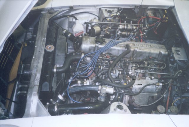

I ran my IC pipe under the pan over 5 years ago. But ran the tube up between the engine mount and alternator. -
