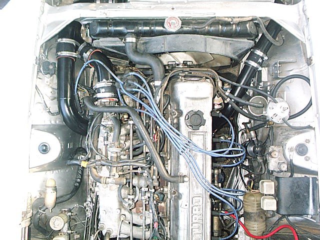

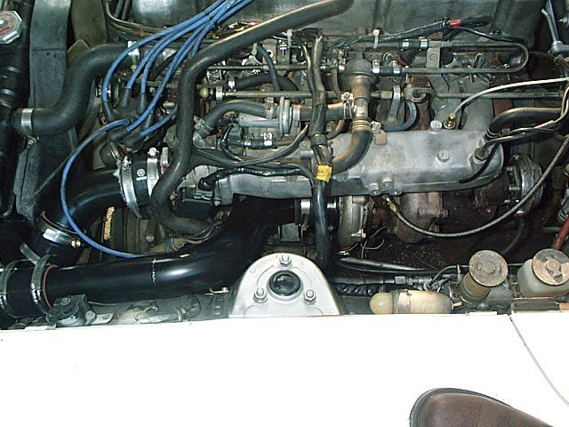

280zx use the rear sump oil pans. I would use a turbo pan because it has the oil return line already in it. But not a big deal to put a drain line into a regular pan. The pan you have on now is a center sump (75 to 78 280z pan). There is lots of room to run IC pipe between the front crossmember and the rear sump pan in a first gen z. I used 2 inch and a friend of mine uses 2-1/4.
install a rear sump oil pan and oil pick up tube. re-clock the turbo downwards. run the pipe under the oil pan and up behind the alternator.
