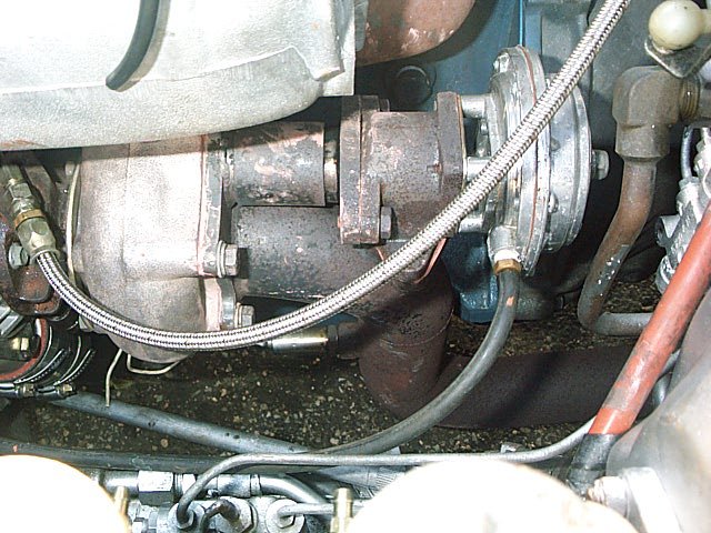

used a 5 bolt hole plate to replace the stock wastegate then bored a 1 inch hole at the stock wastegate site of the T3. I also used a slip fit joint at the top and two hole flanges at both ends. Yes, I'm happy with it. no problems for over 5 years now. It is a 76 280.
