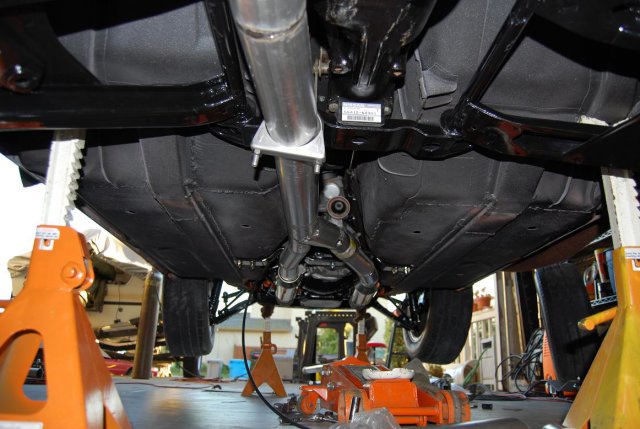

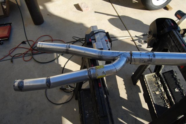

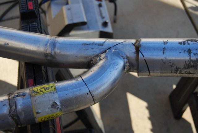

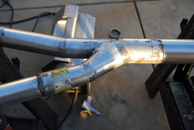

A couple more pictures. I had the Y built, and then decided I didn't like how it joined, I wanted it to be a little more gentle, and a little bigger. So, I cut out that section outlined in pen, and cut a 3" pipe to fit over the area, to create a more gradual transition. Lastly, I put it in place. Now, all I need to do is weld it to the resonators, and fab the two 90's once the muffler gets here today. It fits perfectly between the differential and the suspension, and is tucked up nicely. From the side, you can only see the two resonators in the front. -

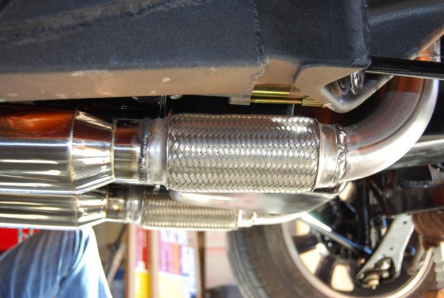

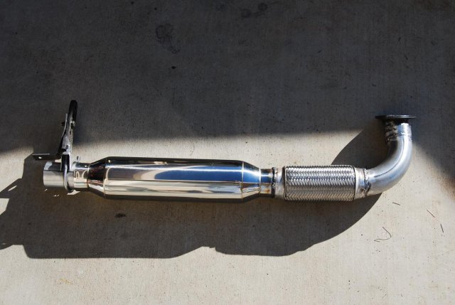

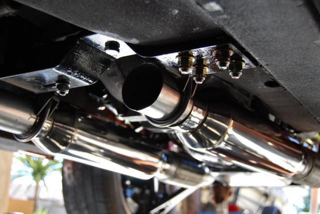

Yet another update... after two days of working hard, and with the help of a knowledgeable friend, we built the exhaust almost to completion. It is fully custom, with just a few pre-bent angles, 2.5" to 3". I waited to order the muffler because I wasn't sure what I would be working with, but I picked it out, and it should be here soon. In case you are keeping track, I will not be using the SuperTrapp, partially because it was going to be a difficult fit, and partially because it's 2.5". I put two vibrant resonators right after the flex joint, then joined the pipes after the transmission. The Y is a creation that we came up with, it's a 2.5" pipe that is flared out to 3", where the two meet, and then 3" from there on. All welding was done with my crappy generic MIG welder. More pictures later today of the rest. -

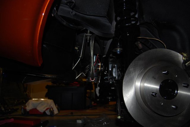

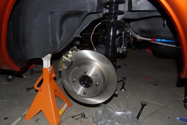

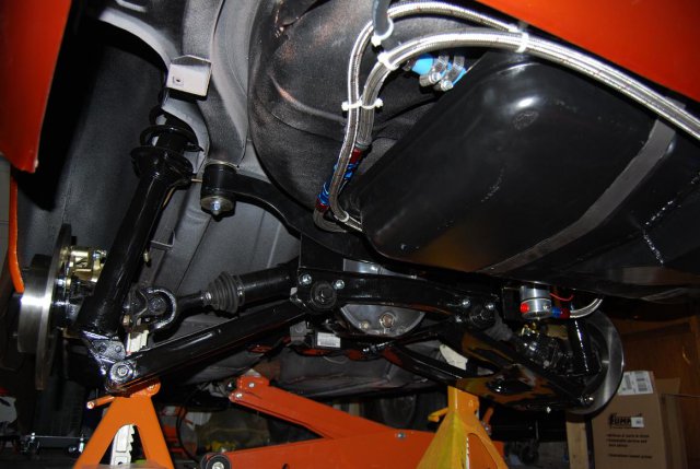

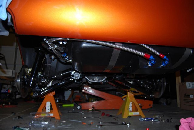

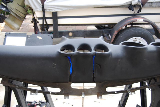

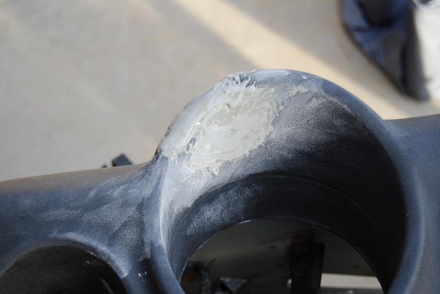

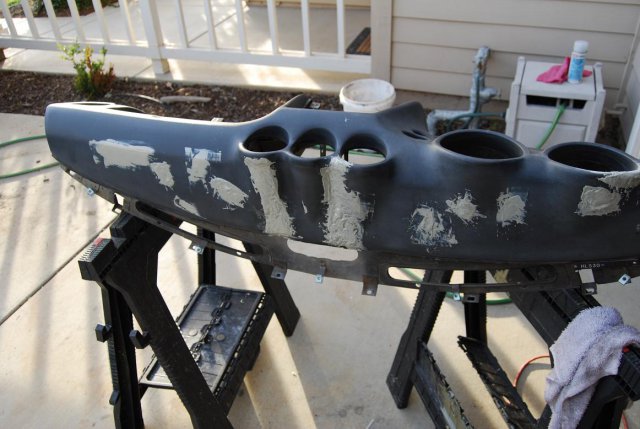

Well, it's been a while since I last posted. Been pretty busy with the Z and otherwise, just haven't had time to get pictures up. Most of the things I've been doing lately on the car are minor, non-visible necessities. However, I have gotten the fuel tank mounted, almost all of the fuel lines built and routed, and I also sprung for the Toyota 4x4 non-vented front calipers and 240sx Modern Motorsports rear disc brake conversion. Extremely easy conversion to do. I've also begun refinishing the dash, repairing it with foam sealant and SEM bumper repair as prescribed in the dash repair threads that are abundant in the Z community. So far so good, but one thing I didn't think about... the bumper repair sands well but takes a while... I shouldn't have globbed it on like I did! Should turn out well though when I'm done with the hours of sanding. -
