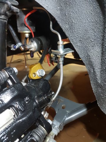

	I unbolted each caliper and bleed them with the bleeder facing up at the highest point. Some air came out and the brakes are a lot better now and the car can actually stop. They're still quite squishy so I'm missing something.
	I was actually referring to a cylindrical spacer I made to lengthen the push rod. I removed that and didn't put it back. Your advice reminds me, though, that I didn't take my measurements with the flange/spacer installed between the booster and the MC, so everything is off by about 0.5" (thickness of the flange). Here are the measurements and adjustment I made to the push-rod last night., but again I forgot to take into account the aluminum 4-hole flange/spacer between the booster and MC. This would add approximately +0.5" to the push-rod adjustment. I took a measurement of the 4-hole flange/spacer and it should change my adjustment by: Can you confirm my approach? I'm not sure how you went from 0.39" measurement to a 0.53" adjustment. Also, thank you for the caliper bleeding tips. My bleed screws are not at the top of the caliper at all, so I will try the bench bleed technique you recommended after correctly adjusting the push-rod. EDIT: @Miles Disregard my comment on how you got from 0.39" to 0.53". I didn't catch that it was illustrating the adjustment to a 240z stock push-rod position to accommodate a 280zx MC. Thanks.
	This may end up being a long post because I want to highlight all of the things I've tried to get the brake pedal to not depress all the way to the floor. 1. I believe the brake booster is a 280zx booster. I had to widen the holes in the fire wall to get it to fit. I purchased the booster from O'Reilys. 2. I did the maxima caliper swap on the rear. 3. All brake lines to calipers are steel braided. 4. I removed the stock proportioning valve insides and converted it to a pass through splitter. 5. I first tried a 7/8" master cylinder and bleed the brake using several methods includ8.ing a pressure bleeder, traditional bleeding, and even an electric pump. 6. I thought that maybe the booster push rod wasn't quite long enough so I put a spacer in the end of the master cylinder. The brakes then worked well enough to stop the car, but only at the last 0.5" of travel. 7. I then removed the spacer and adjusted the push rod to almost touch the master cylinder plunger. The brake pedal still went to the floor with no stopping power. 8. I then removed the booster and checked that the reaction disc was still on the push rod. It was. I epoxied it to the push rod just in case. I reassembled the booster. I set the push rod clearance to 0.3mm. 9. I bench bled a 1" Wilwood master cylinder until there were no bubbles. I removed the check valve from the rear brake outlet. 9. I installed the 1" Wilwood master cylinder. 10. I installed a Willwood proportioning valve/switch in place of the stock brake switch/valve. 11. I bleed the brakes using the pressure/pump bleeder. It's basically a round-up sprayer with a cap you place on each reservoir and pump it up to 15 psi or so. I started at the furthest away wheel, then the rear left, the front right, the front left, and finally the MC itself. No bubbles come out of the calipers unless I loosen the bleeder a lot, at which point I think it's sucking in air from around the bleeder screw so several small bubbles show up at that point. After bleeding the pedal still depressed to the floor. 12. I then got a helper to pump the brakes and I bled each caliper the traditional way. The pedal STILL went to the floor. I'm out of ideas and at a loss. Especially after dripping brake fluid on the fresh paint and melting it. Does anyone have any ideas that might help out? Could the calipers themselves be screwed up? Is there a second bleeder on the calipers that I need to bleed?

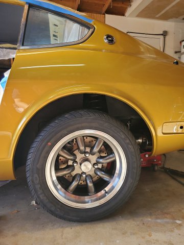

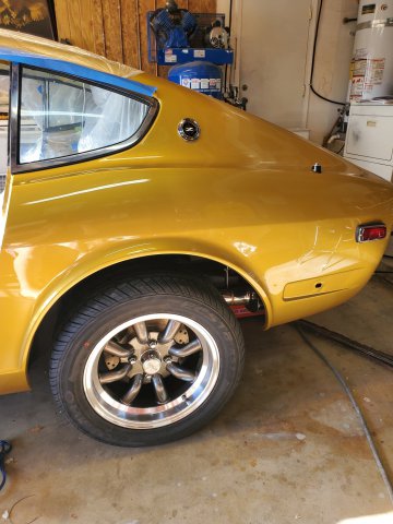

Excellent. Glad you got the bearing out without damage. If you want some new 1/8" balls shoot me a PM and I'll send them your way free of charge. I bought 100 of them after all. What body kit is that? It looks far out. Gotta make room for those wheels. I'm on Konig Rewind 15"x 7s. What's your tire size?- 76 replies

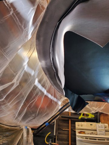

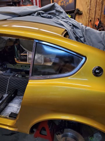

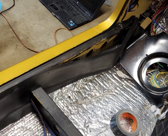

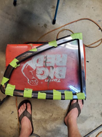

Recently I put in a new headliner. This wasn't as difficult as it seemed at first, but it certainly helps having two people there. I also started putting in new window header vinyl. This took a few tries to get it smooth. I'll upload final pics of this tonight or tomorrow. I also rebuilt the quarter windows with new inner and outer weatherstripping. These were pretty hard to get back into the car because the weatherstripping doesn't like to compress. I found using longer M4 screws helps to grab the screw hole threads and pull it in. This would have been easier with two people -- one person pushing on the window while another threads in the four screws. I also started laying down the interior vinyl (transmission tunnel, strut towers, inner-rockers, wheel-wells, etc. I went with 15" graphite Konig Rewinds for wheels. I put these on and over the the course of just 48 hours the car settled and the tire/fender gap looks great now!- 76 replies

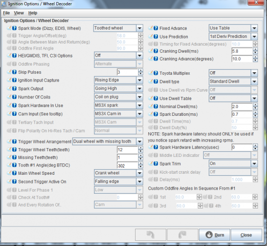

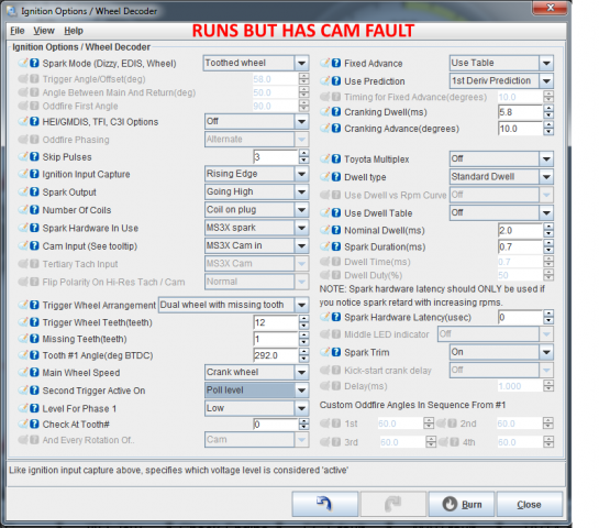

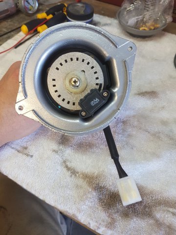

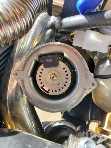

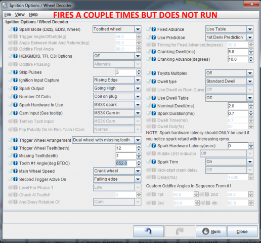

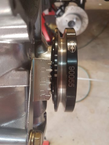

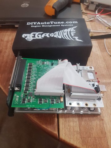

	I'll follow up on this for archive/search purposes since it's been resolved. I did get the car to finally start using the following settings and in full sequential and COP mode with no CAM Fault and full sync. I'm not sure why it didn't start the first time I had this settings burned on the MS3. I did find my timing was off by 10º BTDC and it's possible the required fuel and VE table may have not been dialed in well enough. Thanks to Matt at DIYAutoTune for helping out.

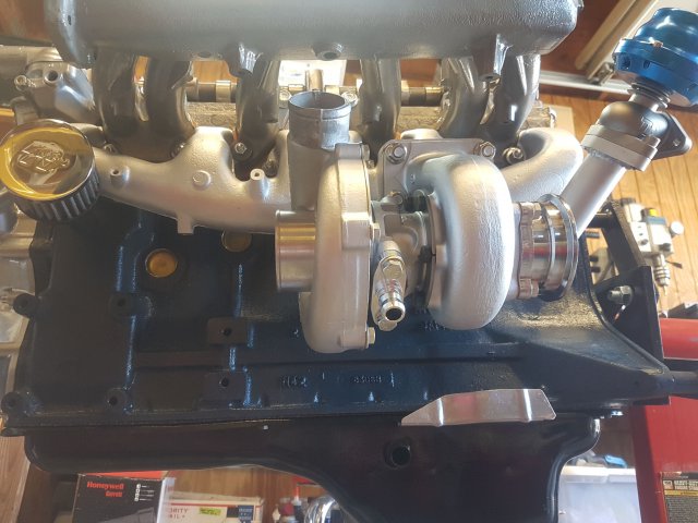

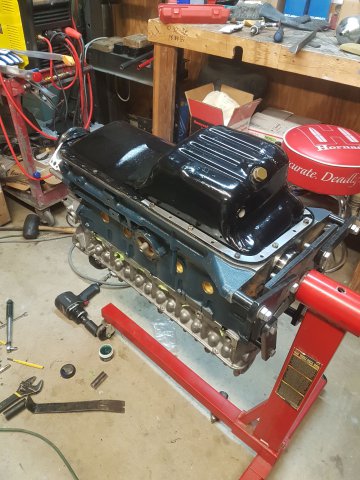

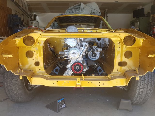

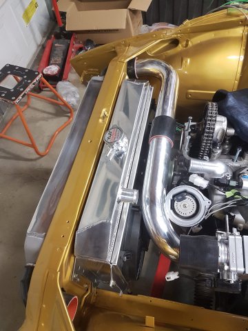

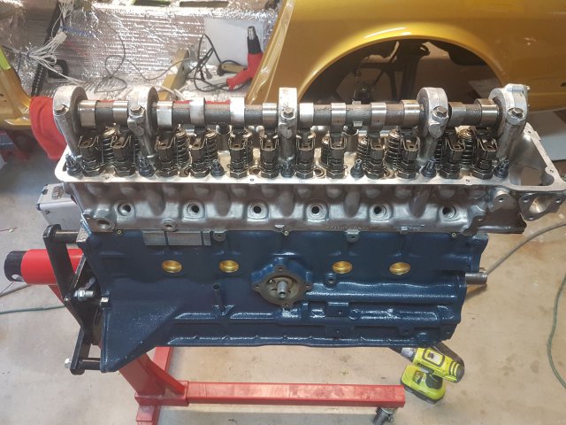

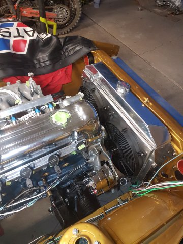

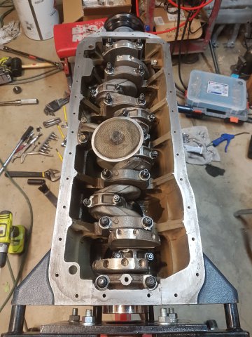

Wow it's been a long time since I've posted. I've been working hard on the Megasquirt 3 with COP and full sequential. I've also been working on the interior, dash, etc. Here's a quick break down of what I've done since the last update: New VintageDash Dash is assembled with SpeedHut gauges Bored the engine to 87mm Moly coated JE Forged pistons with contact reduction and accumulator grooves ARP rod, main, and head bolts/studs installed New timing components installed Turbo oil pump installed T3/T04E Garret Turbo 50Trim 0.63A/R. Ceramic coated. Ceramic coated exhaust header with external wastegate piping TiAL BOV and Wastegate install Treadstone Intercooler install Champion 4-row radiator installed Twin 12" electric fan install 3" stainless steel exhaust from turbo back. Custom welded. Wideband O2 installed in exhaust DG508 coils installed Palnet fuel rail installed RRFPR installed Gas tank installed Fuel surge tank installed Carter P4070 lift pump and Walbro GSL39 primary fuel pump installed Classic Tube stainless steel fuel hardlines installed from Classic Tube stainless steel brake lines installed Custom fabricated braided SS brake lines Installed brake booster Installed brake master cylinder Installed clutch master cylinder Installed E-brake cable Engine run at idle on full sequential and COP Reflectix heat shield installed on interior Leather diamond stiched vinyl installed 20190909_200433_1.mp4 20190703_194045.mp4- 76 replies

	I tried adding 360 degrees to the tooth 1 angle to put the cam in the other phase per Matt Cramer's suggestion. This seemed to get rid of the cam fault during cranking, but now the engine will not start. The engine only starts with Second Trigger set to Poll Level in Full Sequential/COP but always has the cam fault. I've tried the other 4 combinations of Ignition Input Capture and Second Trigger Active On and the engine will not start. It fires a few times but then dies. I've tried adjusting the required fuel up and down as well as the VE table and I still can't get it to start.

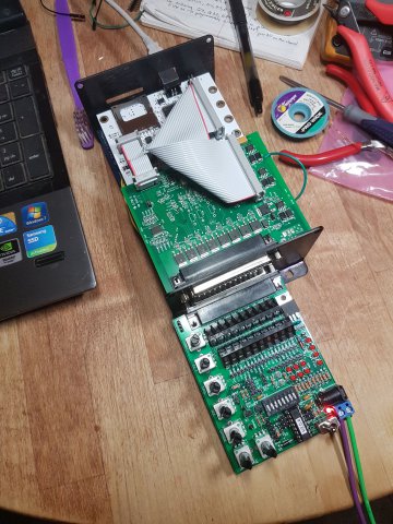

	Hey y'all, I'm a little stuck on the cam fault issue I'm having in Tuner Studio. Here's my setup: Turbo Datsun 240z Full Sequential/Coil On Plug 440cc Supra Injectors DIYAutoTune CAS Wheel in an '83 280zx Distributor IAT MAP Wideband LC-2 DG508 Coils Powerforce Damper I went through all of the checkouts in the manual using the JimStim and JimStimX. Using the JimStimX, though, the correct setting for 'Second Trigger Active On' ended up being Falling Edge. When I installed the MS3 in the car I can only get it running with 'Second Trigger Active On' set as Poll Level. It idles but I get a Cam Fault in Tunerstudio. I attached my msq and a composite log. Looking at the composite log and the physical CAS wheel it seems like the cam trigger should be aligned with the 11th tooth, but it's not. I've read elsewhere that this fault is because the cam signal is on the wrong phase. I tried switching the CAS wheel and distributor (not the shaft but the distributor itself) orientation 180 degrees to no avail. Any insight into what's going on here? 2019-09-13_16.46.35.msq 2019-09-13_16.04.34.csv
