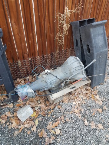

240z seat. Comes with all hardware and tracks $50 '78 280z Auto Transmission with replaced seals $50 Price drop on the N47 head!!! HEAD IS SOLD. Located in Tehachapi CA. Local pick up in the area accepted, otherwise all prices do not include shipping. I had this head rebuilt years ago and only ran it at idle a few times before pulling the motor again. It's ready to put on your motor. Head specs: 1978 N47 Resurfaced head Resurfaced rockers 3-angle valve job 300ZX springs Schneider Stage 1 Cam (260/260 duration, 0.460" lift) Asking $750 $650 $575 $500 240z front and rear bumpers. Front bumper has damage. Rear bumper is in good condition. Front bumper: $25 Rear bumper: $50 '78 N47 Stock NA Header in fresh VHT Ceramic Coating $100

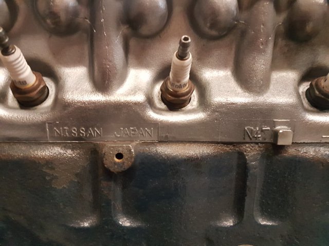

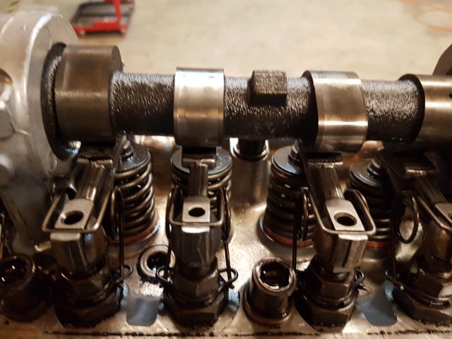

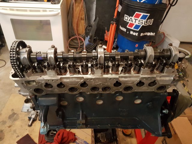

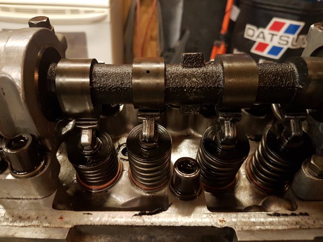

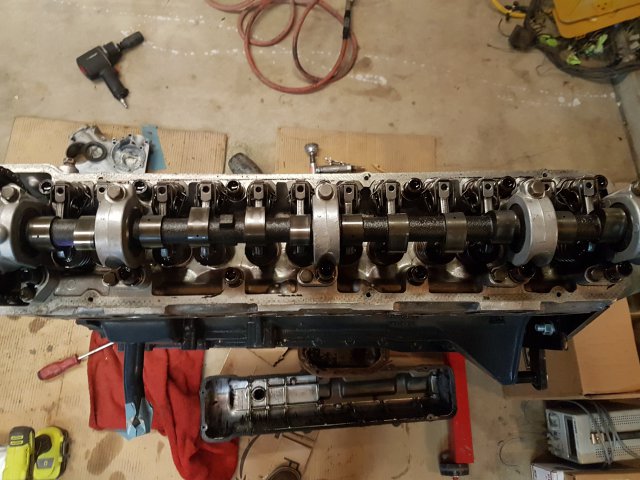

I had this head rebuilt years ago and only ran it a few times before pulling the motor again. Head specs: 1978 N47 Resurfaced head Resurfaced rockers 3-angle valve job 300ZX springs Schneider Stage 1 Cam (260/260 duration, 0.460" lift) I'm strongly considering going turbo since I have a rebuilt P90 sitting on my bench. If I can help pay for the turbo build using this head that would be great. What do you guys think I could get for it? Thanks,

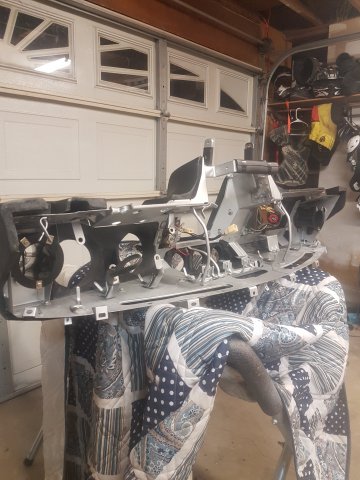

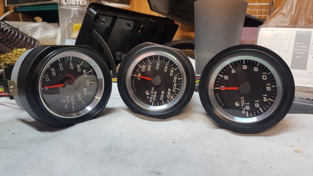

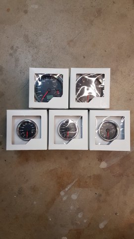

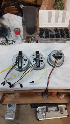

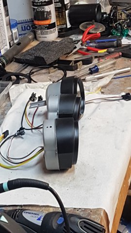

I've been working on the new dash gauges. I got all new Speedhut gauges in 4.5" and 2 5/8" -- GPS speedometer with fuel gauge, tachometer, oil pressure, water temp, and voltage. I was able to re-use the original housings for the 2 5/8" gauges with some modifications.- 76 replies

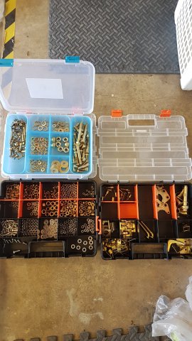

I had the majority of the original hardware cadmium plated. Here's a picture of some of it. Most of it came out nice.- 76 replies

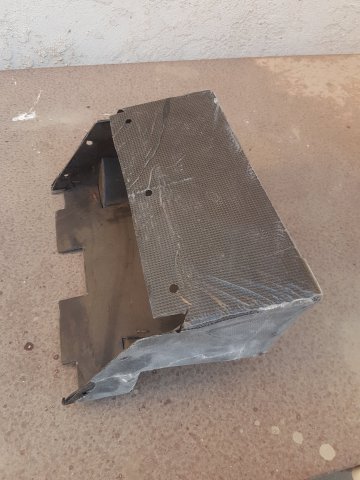

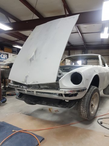

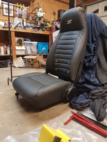

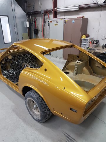

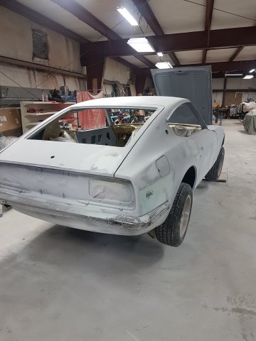

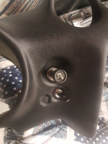

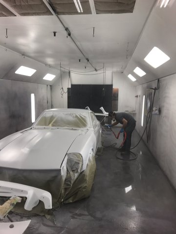

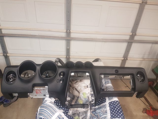

I ordered all new badges from a variety of different places. I ended up completely disassembling the steering column and refreshing the top and bottom bearings with new balls. I also added a couple extra balls to the bearing to tighten up the steering a bit, hopefully. Also, a new glove box badge. I was also able to find a replacement for the needle bearing in the bottom of the column. I ordered new leather upholstery kit from Interior Innovations, including seat covers and new foam. The cardboard glove box was beginning to deteriorate so I did a 1-ply carbon fiber lay up all the way around it to reinforce it. It's not pretty, but no one will ever see it! And it should last much longer now. I reassembled the car, aligned all the panels, shot new primer, and then brought it to a body shop to finish it up. I just couldn't bring myself to risk screwing up the paint on it after putting so much time and effort into it. Here it is at the body shop getting the primer blocked down and getting new primer in preparation for wet sanding. I ordered a new dash from Vintage Dashes. It ended up being pretty nice. I'm currently in the process of installing all new Speedhut gauges and re-wiring the dash.- 76 replies

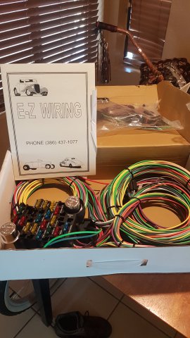

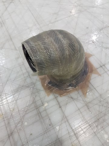

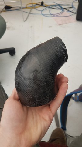

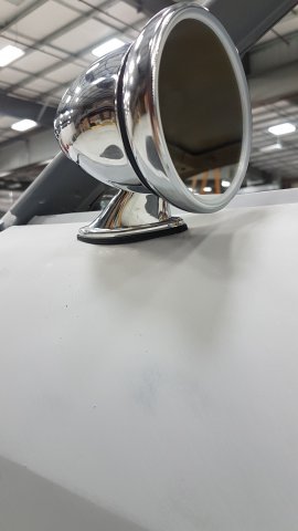

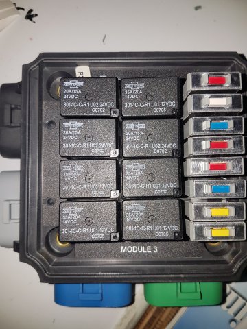

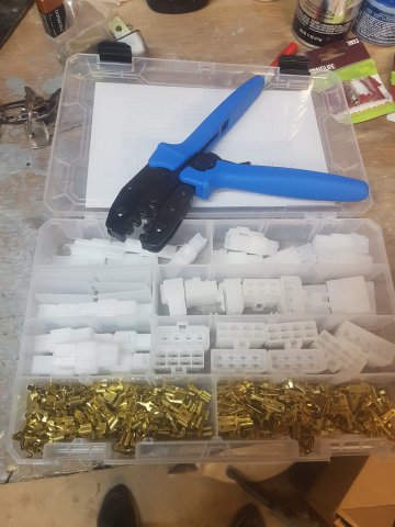

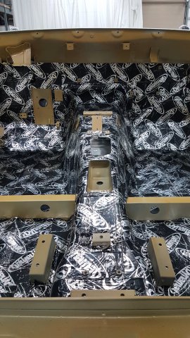

I've been doing a lot of miscellaneous stuff when I get the chance. I purchased a relay box from ebay that I think I'm going to use instead of the OEM relays. Also purchased all new Vintage Connectors and an EZ Wiring harness. I went ahead and mounted the bullet mirrors. One of the fresh air duct vents was completely destroyed so I used the good one as a tool to make a fiberglass one. I laid up the glass on a teflon tape wrapped vent and it came out pretty nice, but was a little flimsy, so I did another lay up with one ply of carbon fiber. I dynamatted the inside of the car.- 76 replies

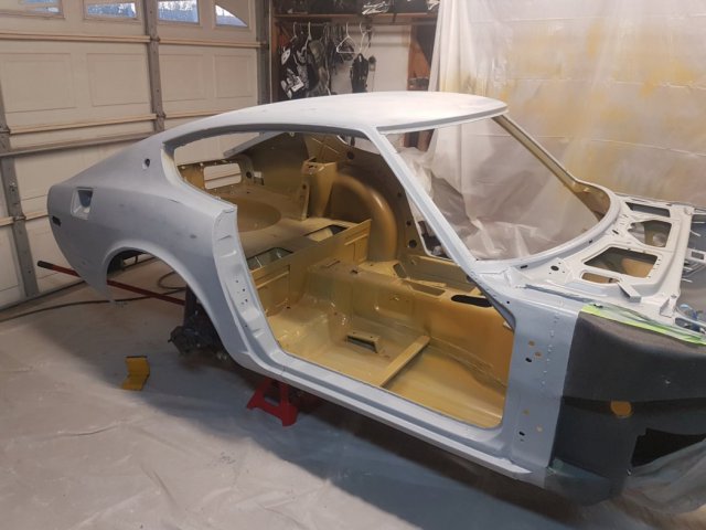

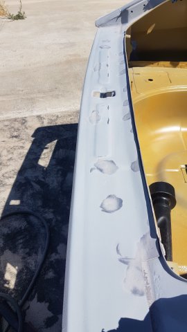

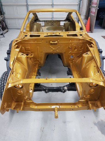

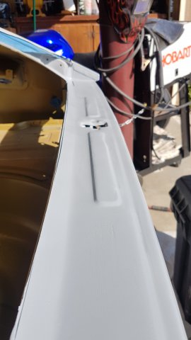

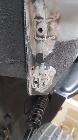

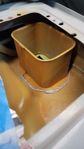

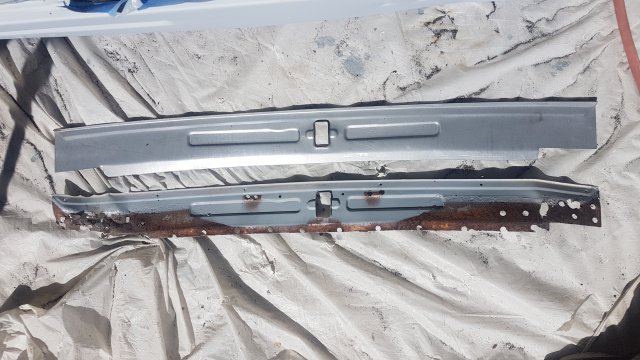

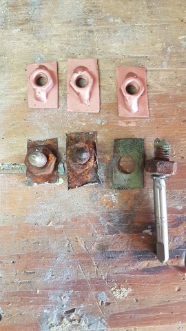

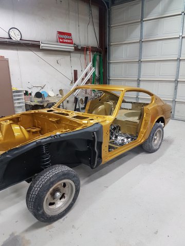

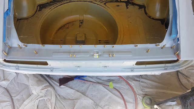

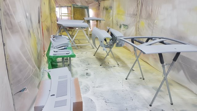

I haven't posted in a while, but I've doing a lot of work on the Z. I stripped the entire shell and all panels down to bare metal and shot epoxy primer on everything. I then sprayed a high build primer. Bare metal shell with some seam sealer masking. All in epoxy Interior in in a light coat of the base color. I sprayed this over epoxy in the recoat window. The body panels getting extra coats of high build. Some things still needed metal work. I replaced part of the passenger side door jamb, welded in new dog legs, and welded in a new tailgate panel. The front fender bottom fastener nuts that are welded inside the frame broke loose. I ended up cutting them out and welding new sheet metal and nuts in their place. I previously cut out the fresh air duct to repair a lot of the rust around it. This is re-installing it. I bonded it in instead of trying to weld it.- 76 replies
