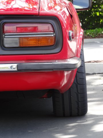

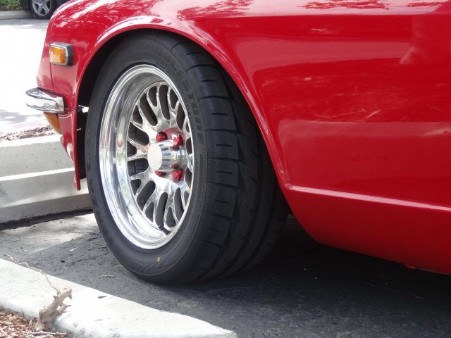

A 16 x 8 with a 245 wide tire will fit without any spacers on a stock body but again to be perfect and especially if you guys want to push it to the maximum and run any size larger than 8" you could fit wider in the rears (255 + ) BUT why be cheap you can rent the right tool to squeeze your offset to the maximum for under $50 bucks. http://www.1320wheels.com/index.php?main_page=product_info&products_id=334 I read the posting of the guy whom stuffed a 275 but that required longer studs, modifications to the shafts, adjustable aftermarket lower control arms, and I believe he had different offsets on one side versus the other for some reason? Thus when you go beyond a 245 you do not want a mistake as the clearance that is left is so small you should not go by what others have used unless your car is exactly the same year, same suspension mods, brakes, etc. and why risk it for $50 bucks and you can measure it exactly for your car? My two 240's both have 245's but the offset is slightly different. You do not need to purchase those expensive tools $250-800 or buy a cheaper quality tool for $100-200; just rent the high quality tool for $50 bucks....

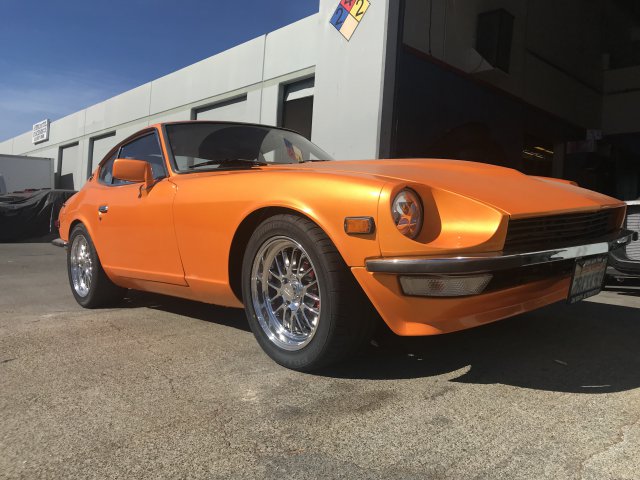

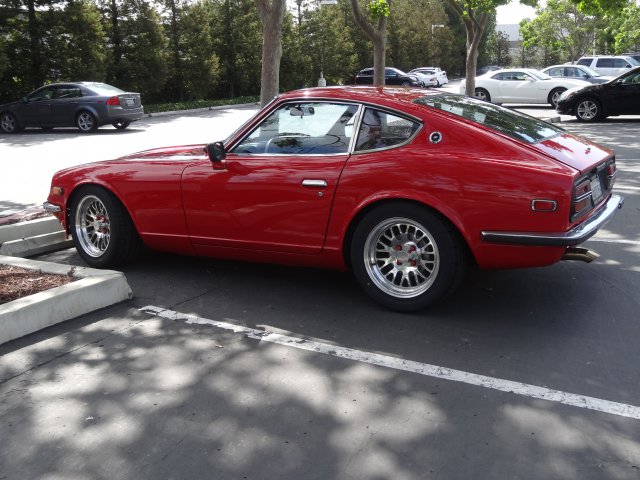

I have two (2) 240z's, one with 16 x 8" with a +13, 5" backspace on all four corners running 245 40's. The other is about the same setup also running 245's on all four corners. The fenders are rolled on both. The orange is not as low but the red one is about 4.5" off the ground. Both cars have no rubbing issues. Both cars have coil overs. Running 245's really enable the car to stick to the pavement incredibly. Rather than going with anyone's specific off-set, I would recommend that you buy that tool to measure the maximum tire/wheel your car can fit or go to a good tire shop and have them measure it. The reason to me is that everyone is likely to run different brand suspensions, etc. I think my Red Z if a slightly different off-set but I cannot remember what it is but I do believe it is 5" backspace, it is closer to a zero offset?. Thus if you measure it you can fit the max for your car. I know on my Red car that I think I could actually fit a 255 if I push it but doubt that would clear in the front so I opted to go front/back with 245's so I can rotate them. I am running about a -1" camber and get pretty good life of the tire (inside 1-2" might be worn down to no tread and the other end is usually at or more than the wear level so with rotating them I get decent life). Both Z's are running Arizona Z car front 12.5" vented 4 piston Wilwood brake setup. The Orange Z is running BC Racing coilovers and the Red Z is running ground control coilovers. Lastly both cars have no issues with turning the wheels to full lock, etc. no rubbing, etc. And yes both cars are running with no spacers....

He is correct, you should either buy one of those measurement tools to determine the ideal offset, etc. or go to a good shop that has one to get the right choice for wheels/tires. On one of my recent 240Z's we are running 16x8" with a 5" backspace +13 offset and running 16" 245/45 series tires. You need to measure it with the wheel tool and make sure you go over the details with the wheel manufacturer to ensure you maximize the wheel size for your car. This car is lowered and the fenders are stock but rolled to ensure no issues.
