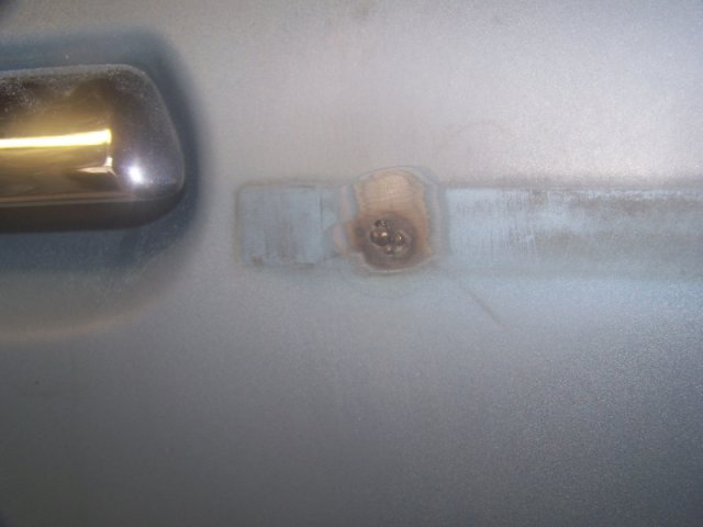

have a few more pics ready for you viewing pleasure...... or hostile comments =0) which ever come first.. now that the clutch, radiator and suspension is done.. body work has commenced. My dad and i stripped the body molding off ( which was in great shape underneath) we decided to try something different with the rivets. Normally we take a little punch and pop in the hole left after drilling out the rivets.. this has led to some waves along the body line that the trim was.. so since we had acces to a welder we decided to weld in the holes which would hopefully lessed the amount of bondo/body work needed. we also removed the lower body trim off which was kinda scary.. every Z we took those skirts off of had tons of rust under since they are riveted on and water collects inbetween and rots it out.. amazingly only once spot had rust. Was a major rust spot but the rest was great. whoever owned this car in Portland, OR must have kept it garaged. all that rain and almost no rust on the car. ok for the welders on here... try not to zing me to bad.. this is my second attempt at welding and we were not sure it was going to work but here ya go The Welder. Door guards removed. random shot of welds and grinding.
