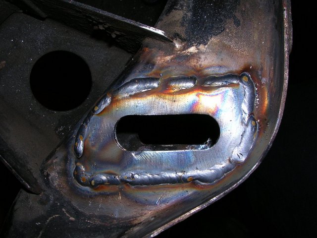

Cross Member Bump Steer Mod
JMortensen replied to Twoeightnine's topic in Brakes, Wheels, Suspension and Chassis
Here you go. Nothing fancy, just a plate welded on each side of the crossmember. I drilled a hole at the two ends, and then used a cutoff wheel to connect them. In retrospect, 5/8" is way overkill for the bolt size. I would probably run a 1/2" bolt and sleeve on the 5/8" rod end if I were to do it again. I guess I won't have to worry about strength this way. -

Read the bumpsteer FAQ post for a primer on bumpsteer. When you correct for it, you can either move the outer tie rod down, or the LCA pivot up. JTR has a spec, and various other sites and people have their spec, but I basically see them all as just guessing. In order to really figure it out you have to measure. I slotted the front crossmember and then moved the LCA up until the bumpsteer went away on the gauge. That point was when the LCA pivot had moved up 1/2". With that modification the car went from doing a sharp jerk on one particular bump at the track to being smooth as silk afterwards, and no more sawing at the wheel in long sweepers on the track. It was a very noticeable difference when I was driving at the limit. So while some say 3/4" up and 1/4" out, and others say 13/16" or whatever up, the best way IMO is to measure it and minimize it.
