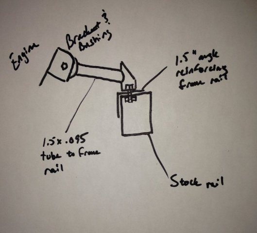

Angle on the tube will be about 18 degrees as close as I can estimate it, and thanks in advance. The tube is DOM, FWIW.

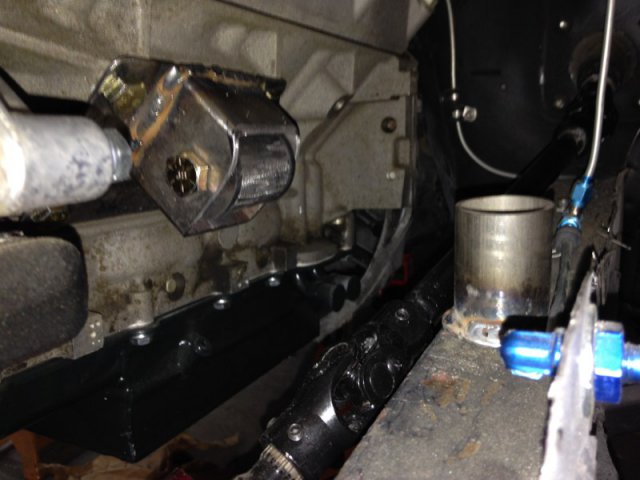

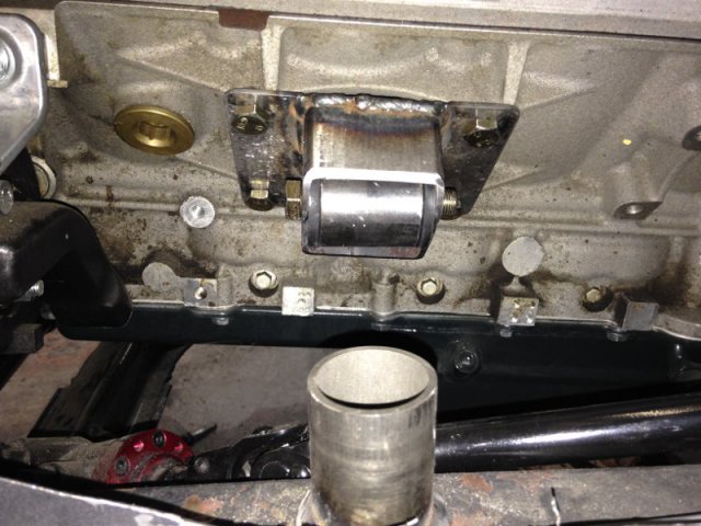

I am making motor mounts and second guessing myself. I've got limited clearance around the steering shaft, so the motor mount has to fit above it, and the engine can't come up and down vertically very much due to the cage members in the engine compartment, so this is what I came up with. I've got a plate with a section of square tube welded on as a clevis which holds a generic urethane bushing setup. There will be a section of 1.5 x .095 tube that runs out above the frame rail, and this will weld to a 2" tall section of 1.5 x .095 which will bolt to the rail. The rail will be reinforced with a piece of 1.5 x .120 angle, and it will have a nut welded to the bottom side for the bolt to catch. Essentially this is similar in effect to the Trans Dapt mounts, but the Trans Dapt doesn't bolt on at the frame end, it welds directly to the frame. http://www.jegs.com/i/Trans+Dapt/969/4501/10002/-1 There will be a slight downward angle to the tube that goes to the frame rail. I dunno why it's bothering me, but it is. Am I being paranoid?
