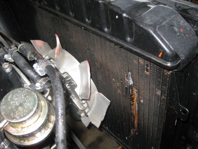

My fan exploded and shredded my radiator.... I'm looking for a clean good condition replacement. Let me know, thanks

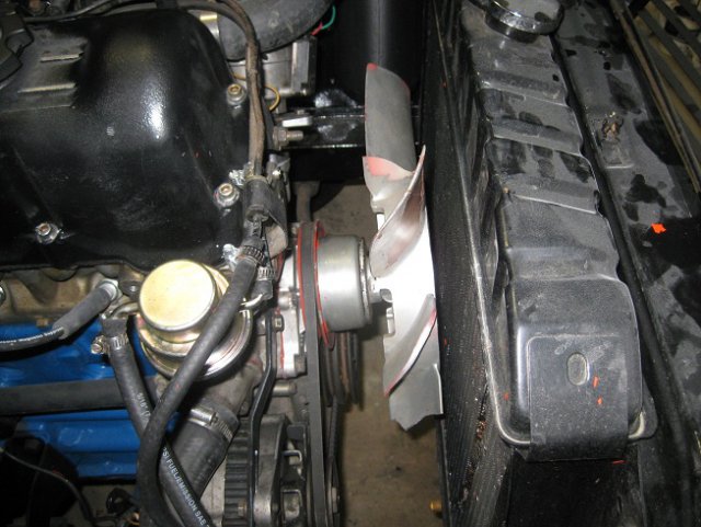

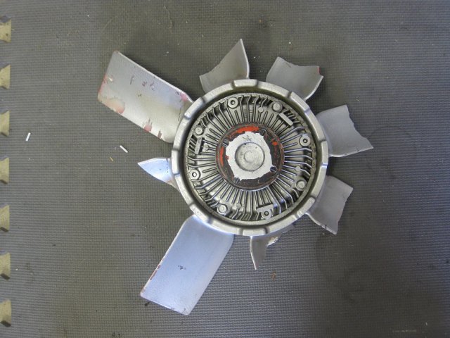

Was my stock clutch fan too close to the radiator
MikeBZ replied to MikeBZ's topic in S30 Series - 240z, 260z, 280z
Yeah the previous owner painted it silver, dont know how long ago. Could have been a factor, but I think I just had an old fan who's days were numbered...... In the 3rd pic I posted I did not bolt the fan back on the pulley, I just set it on for the photo. When I took the fan off after the damage all of the mounting bolts were tight. -
There isnt any major damage to the underside of the hood, a few knicks and dings but nothing indicating pieces of fan blade at high velocity. The water pump is brand new, no play. It's the angle of the photo, theres a good three inches space between the blade and the stock fuel line. (I set the fan back on the pulley for the photo, I know its not bolted on) -
Hadn't thought of that, I went out and shook the car back and forth by the engine and the mounts seem pretty firm. I also put a jack at the back of the trans and the trans mount is good too.. -
The radiator is not that old, and is mounted very firmly using the 4 stock mounting bolts. The core support is solid as is the radiator core and surround. There is one major wound to the radiator I think the other cuts are from the fan blades breaking and flying off. Do you know how much clearance theres supposed to be between the fan blades and radiator stock ? I dont know if my clutch fan is original, I think they started using plastic fans in late 71 or 72. Earlier were metal. -
I've only had my Z running for a little while. I've taken it around the block for a few shake down runs. But today I got on it a little (4500 rpm) and my stock clutch fan let go and took out my radiator.... Luckily I only put water in it and was close to home. Its the stock clutch fan that came with my 71. And a stock type replacement radiator. No shroud, and the fan was 1.25 inches away from the radiator.. Was it too close to the radiator, or was the fan just having a bad day ?

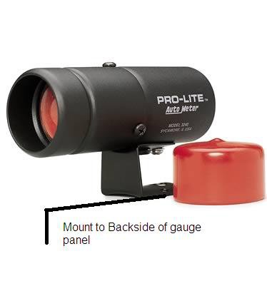

Yeah the mechanical are quicker for oil pressure, as far as mounting the warning light in the dash you could use an "L" type bracket to recess them, I put one in the clock spot.
I would add idiot lights for oil pressure and temp. Autometer sells some that are the size of shift lights and they work well. I think using electric gauges is a good idea especially for racing. I had the feed line to my oil pressure gauge break and spray hot oil on my legs and feet. Now I stick with electric gauges I agree on using relays, I put them as close to the device as possible so the current doesnt travel as far. HD switches can handle the load as well, but then that current is running from the battery to the switch then down to the device creating a lot of heat along the wire.
