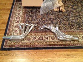

LSx s30 Longtube group buy thread
RebekahsZ replied to 1 tuff z's topic in Gen III & IV Chevy V8Z Tech Board
After all the belly-achin' we've been doing: it would be great if every guy could post his progress or at least their excitement when they have these headers in and installed. It would also be cool if any associated dyno results and engine configurations (intake, cam, heads, down-stream exhaust system, etc) could be posted as we each get them. Blake may have to adjust his pricing (probably up) to make sure this is a win-win, but it would be great if we could keep this going; perhaps this is a product that we could keep available for posterity. Who knows, maybe Blake could do something crazy like sell his prototypes to Sanderson or Hooker and make a million bucks. Lets all quit belly-achin' about the gaskets, too; after spending $1200 on a car that is worth $3000 on a good day, we shouldn't be all that upset about a $50 problem. When I had my car stripped and painted 20 years ago, the painter under-bid the job and had to work in other jobs around mine to keep food on his table. A supposed 3 week job took 4 months. I put our header saga in the same category as that one. 20 years later, I still have a great paint job. And, since these headers are stainless (and some are coated), they should last us a long time too. As for me: I have build fatigue and will not likely be putting my headers on THIS car. It is 107-degrees in Alabama today and I ain't goin' in the garage, cause it is likely over 115-degrees in there! That obligates me to build a 280z-based hybrid in the future, maybe by then I'll be installing an LS-12 or something. That car will correct many of the do-overs I'd like to do on this car, and there is a long list. I finally unpacked the box of headers (see photo). My father in law is on hospice in our home, so everything is taking longer than I'd like. Well, the v-bands were left off. I just checked the sign up list and I did request v-bands. But, I'm not gonna sweat it since they'll likely need modification to fit the floorpans anyway. They are still so beautiful. Primary length is about 24". I'm keeping them. -
