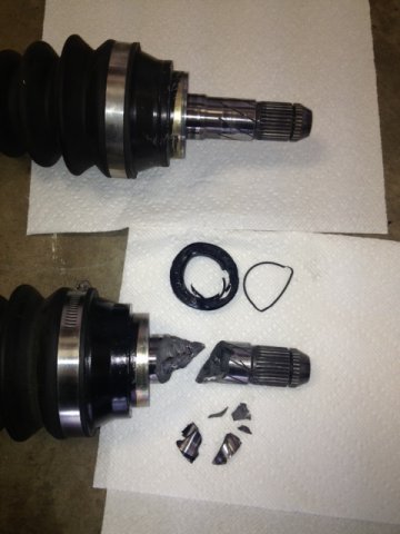

  8. ZFan1-Where did yours break? Both of SunnyZs broke same as mine: driver side on the stub between the splines and the inner CV. Mine were fine until I switched from 26" to 28" tires (unless the crack started earlier). What tire were you running and where did the failure (s) occur mechanically?

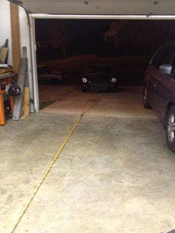

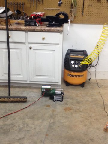

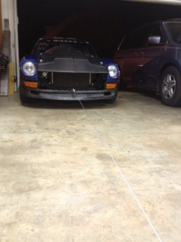

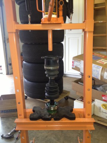

  19. Pics. I had to put an ATV 3000# Harbor Freight winch in the floor of my shop to get the car up the steep driveway (not enough folks from Sunday School showed up for Sunday night coffee)! It worked like a charm. Also put my wife and my new Harbor Freight press to good use pressing the CV onto the axle shaft. This worked a lot better than the 2X4 and hammer method. The trick is guiding the c-clip into its groove as you are starting to press them together. Also, it helps to have flipped the outer cage so that the shaft is directly underneath the grease cap so that when pressing on the center of the grease cap I was actually pressing on the end of the shaft itself. If the cage isn't flipped, there is a risk of bending and ruining the grease cap and they aren't available anywhere that I know of. In the pics of the broken axle, the seal spring and the little chips were found on the ground at the track where the breakage happened. Using hose clamps for boot retention made reassembly really easy-fighting those fancy CV clamps that come with the boots is a pain.
