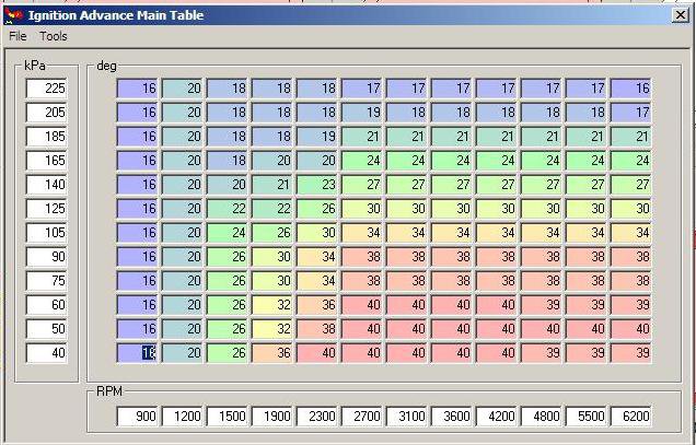

    So is anyone willing to share there spark tables? Just remember to put what your setup is when you do this so that people have a reference to start with. Here is my setup for the above tables: MS 1 V3 with 29v Extra code 82 ZX turbo motor with N42 head using turbo cam T3/TO4 turbo intercooler Tial BOV running 12 psi boost manual DIY boost controller 60mm TB Thanks

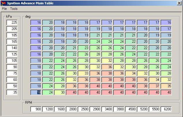

    Matt, It was just something that I thought that I would try and it worked, go figure. Do you have another idea that I can try? Also if anyone has a spark table that works with there turbo setup I would like to look at it? Thanks

    Thanks for the heads up Moby! Well for some reason when I export my spark tables it gives me the VE table instead?? However, I managed to capture the screen and provided it in my first post. I should know better then to post stuff without first looking at it!!

    Hi All, Well I have been working an issue with turbo surge, as mentioned in this thread: http://forums.hybridz.org/showthread.php?t=129000 Well I desided to try something and see what happened. I started playing with the spark angle and I have almost gotten rid of what I thought was turbo surge. Not really sure how I did this but it works so I will take it. So if one of the MS gurus can explain it to me go for it! Here are my old and new tables. Hope this helps someone out!
