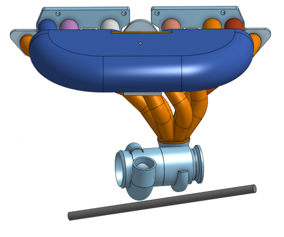

Woops, I lied. I changed the diameter of the pipe, but not the radius. Fixed it. Interior volume is down to about 2.4 liters, put the bends back to 90 degrees since the depth is well under control now. Distance in the axis the runners aim in the intake has a max length of 13". If you tape a tape from the gasket surface to shock tower it sits at about 15" as straight of a line as you can go, so this is certainly in the ballpark of "just fine" for prototype dimensions. Also, aluminum pipe dimensions are 2.25"OD with 3" radius bends for those corners.
The plenum was measuring mightly close to the shock tower, plus my throttle body was based off a 65mm unit, which seemed too big imo, so I swapped out for smaller diameter pipe for the outside curves, which also use a three-inch radius bend instead of 4. I also cut the bends short, so instead of rotating 90 degrees they come out 70 degrees and then terminate, giving a more squat plenum. It might look small, but calcs are still showing it's a 3+ liter plenum. Plenty enough for a turbocharged L series imo. I might be worried if it were an all out NA build, but I don't think top end would suffer much, especially since if there are lean/rich cylinders I can adjust accordingly per cylinder as long as I know which ones they are... Also, swapped the throttle body sketches out to adhere to this generic 60mm unit: https://www.ebay.com/itm/60mm-2-36-Universal-VQ35TPS-Aluminum-Throttle-Body-Intake-Manifold-Billet-Blue/271743038867?epid=4008212244&hash=item3f4525b593:g:0BQAAOSwAuZX17pO&vxp=mtr
Yeah, I did flow analysis of a similar design in SW before but I've given up on maintaining a SW installation. One of the nice things about onshape is that it's public, so if you follow my links and create an onshape account you can export the design yourself Could even copy it and make adjustments to your copy In my previous flow calcs it was really hard to get what I felt was accurate results. The problem is that flows are dynamic in any engine so you need to model a plethora of pressure differentials to really see how the intake performs in transient areas as well as raw mass WOT flow. In ANY case, the flow should be better distributed than OEM as well as most non tapered front entry designs. Judging from some of the other flow simulations I've seen, the best addition I could add would likely be a tapered entry point coming down to the throttle body mount. That would help prevent massive low pressure areas right outside the throttle inlet at that entry surface. The far side being flat is likely not as much of an issue as one might assume since there's almost always negative pressure from valve to throttle. The HIGH pressure areas of concern stem from a relationship between valve closing and runner length. When the valve closes pressure builds up and can start disrupting flow on adjacent cylinders. This is really mostly an issue with short runners at lower rpm (which is like, duh) but it's a design consideration that should be attended to when looking at drawbacks/pros/cons.
More updates on the turbo model. Turbine side is now much bulkier to match the drawings exactly, and the compressor outlet extends further out, which matches pictures as well as I could (no dimensioned drawings from the front face I can find), and also extended it towards the inlet a tad. I also added the dimension for the back plate ring for the compressor, though the front edge of that isn't "realistic" as it doesn't match that diameter in a full 360-degree ring, so if I can fit what I drew then I'm on the safe side. The turbo "slug" as I call it, now matches the dimension drawing from Garrett as identically as feasible, other than the cartridge area, which is of little concern to me. Also for those curious, centerline of exhaust outlet is 2.5" back from the manifold centerline, and the turbo is clocked 15 degrees. Alignment looks great, though I also know I need to go get some shock tower measurements... But hey, what's a hammer for anyways? Also, go figure, it's MUCH easier to run the downpipe when you toss in prefabbed dimensioned pieces and just rotate to fit right (kinda like real life, knock on wood). I used two 45 degree bends and getting it to fit is trivial, though it looks like the straight between the two bends could be swapped out for a 3" length (I used a 1, 2, and 3 inch straight as seen).
I took some time to get rough measurements of the block and then also refined the compressor dimensions (radial diameter was short a few mm). Keep in mind there's no oil pan modeled, but the clearance looks better than oem in several directions. Also for the record, the downpipe pictured is about 51 degrees on each bend. Not quite down to 45 where I'd like, but there's some wiggle room there.
Yeah, steering shaft is what's in the model. The EFR turbo is quite a bit longer (almost 20%) plus normal rotation only, so the turbo HAS to go further forward, as you can only get the header so close to the block. Getting block dimensions to make a block mock up slug is the next step. I know the block is slightly narrower than the head in some areas but also has the PCV bulge to deal with. My steering rack dimensions likely aren't perfect, but probably +/- half inch, which I could easily adjust for at the manifold output plane come time to fabricate. Also, it helps that the G25 is TINY. If Garrett makes good on it's claim the g25-660 will be the smallest turbo capable of breaching the 600hp range (that I know of at least). The G25 turbos are SMALLER than the stock L28ET turbo...
As much as some rave about the EFR turbos, even if the new Garrett G series isn't as fast to spool, reverse rotation just makes packaging so much easier. I'd likely end up needing to push manifold outlet centerline about 3" back from center (being between cylinders 3 and 4 intake runners) unless I want to modify the engine mount, which is how much this manifold is pushed back. Note that all runners going into the collector "easily" merge in at straight angles, no bends going past the collector weld point. The other nice thing about pushing the centerline 3" back is that with the slight kick out of the compressor towards the shock tower the outlet starts to look preeeetty nice in relation to the intake throttle location. Going back another 2" I can straighten the turbo out some, but then merging at the collector starts introducing some harsh angles that'd be difficult to work with. Also for the record, the exhaust is 1.5" stainless pipe 16 guage (.065 wall thickness, giving 1.37" ID) all 2.25" radius bends. Basically modeled after this: http://www.mandrelbends.com/mandrel-bends/304-stainless-steel-16-gauge/1-50-304-stainless-2-25-radius-16g-180-degree-mandrel-bend.html Some might say to go with a thicker gauge, which I wouldn't exactly disagree with, but I'd be more likely to opt for an extra plane of support for the manifold to help support the weight. Wouldn't be hard to tie in a support at the engine mount, possibly even with some form of spring steel to allow for a bit of growth at temp.
Since we're still reeling from the Great photobucket crash of 2017 I'll upload some NEW work: (Attached) Yes, I'm still planning on making manifolds eventually, but I'm pretty focused on just having a running car at the moment. The long term plan is to pick up a spare block to build and mock up manifolds on once life settles down a bit, then I can have a full motor to drop in and tune with existing MS3x setup. Also, this was done with onshape, which is free for public use (basically follows the github service model). Sharable link here: https://cad.onshape.com/documents/69138e072b4b326c0a2e3a2e/w/d59f83eedb6e360e9d84c5c7/e/6f6f6549057b631d83e9ecf1 I've also got a dimensioned Garrett G25-660 in my files if you want to copy that as well. (pictured is a turbo dimension slug based upon the BW EFR 7163). Both turbos I've mocked up are intended for a vband clamp on the turbine inlet. This is intentional as it would allow me to focus on getting the flange "flat"(relative to ground) and then rotate the turbo as necessary to make the downpipe as straight as possible while clearing the steering shaft. Disclaimer: I warn you that I can't guarantee the accuracy of port locations, ESPECIALLY THE EXHAUST MANIFOLD. The intake should be close, as it's based off Ron Tyler's flange dimensions which put my port floor even with the oem port floor, requiring porting to bring top of port up to flange dimensions. The exhaust side is largely a guess of the MN47 round ports with their liners and all. If/when I get to building this, I suspect I'll make the flanges "blank" with locating dowels, then drill roughly located ports and then grind them up to match the head port. This would ensure the flange fits MY car, and the onshape parts are simply for mock up estimates only. The steering shaft should be +/- 1" (or less imo) but like me you should plan to place your own turbo in your own bay, weld up stay rods to match the flange to turbo locations, then transfer that to your welding bench so you know it'll clear once made. I take no liability for ASSumptions you make by viewing these documents
