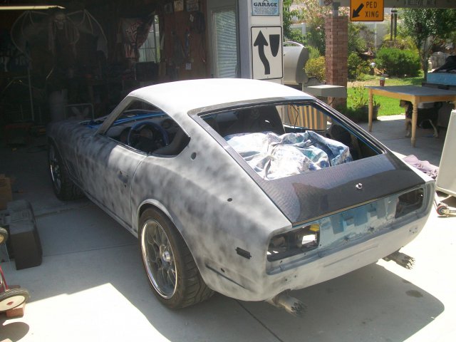

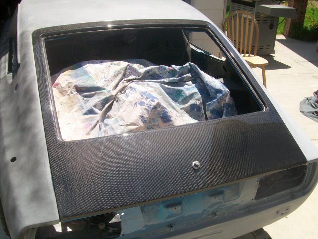

  15. So I bought and received a carbon fiber hatch last week. I got it from Raceonusa and I'm very happy with the overall quality as well as the fit. I'm installing it using the stock hinge and latch and I thought I'd show a couple of pic's to show how it looks now. I can post more pic's and details of the installation process depending on demand. So far I had to remove the part of the hinge that was welded onto the old hatch and bolt it onto the Carbon Fiber hatch. Then it just bolted to the rest of the stock hinge still on the car. It didn't come with the hole for the push bottom latch, so I drilled it myself and gave it the notches the same as the stock one has. It installed easily and looks like it will work great. If you want any specific details or pictures, just let me know and I'll add them to this thread.
