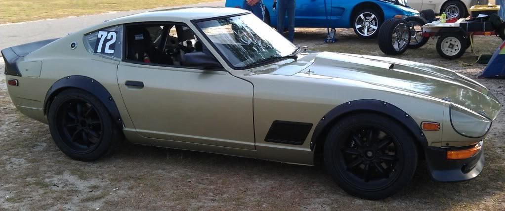

AURGH! Anything that could have went wrong on Friday did.. I was wrenching until 7PM when we loaded the car on the trailer. The Z kicked ass when it was out there.. passing/lapping everyone on the first session. However, there were MAJOR cooling issues. I need to work out a radiator surge tank, oil cooler and fender vents for the Z. I'm going to try and find a way to make the fender vents like BJHines to see if that'll help any. Also, I found out they used a OEM thermostat! So sad.. so I found an aftermarket Nismo one that opens at 145deg opposed to the OEM ~170deg..
this is BJHines's car.
