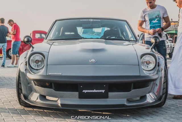

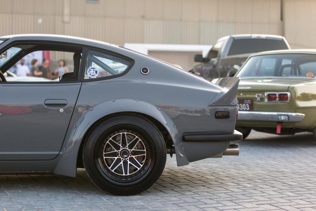

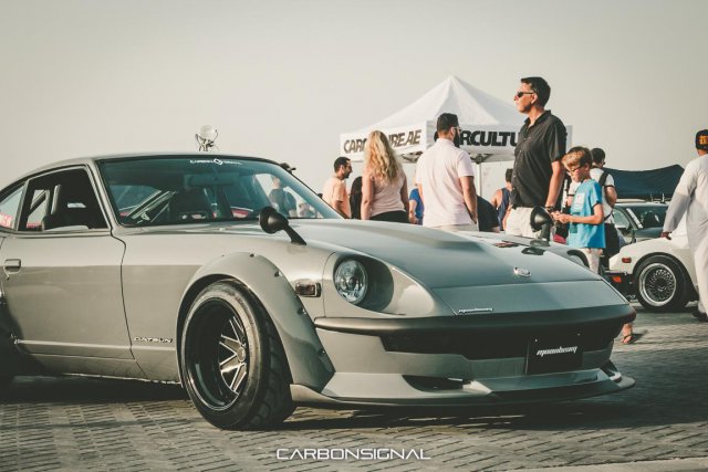

Been a while posting back to show the update, took a while to finish the car back when opened it during its glory

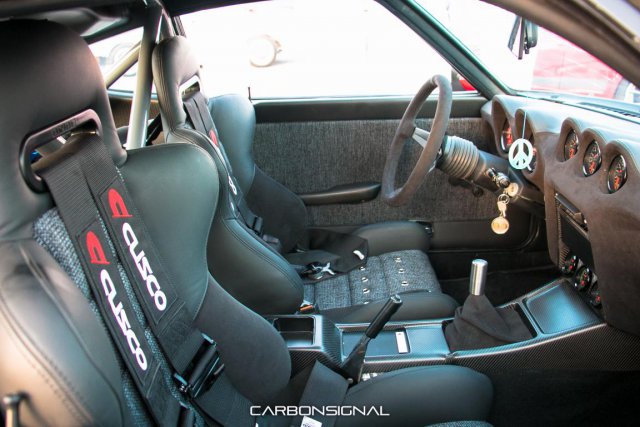

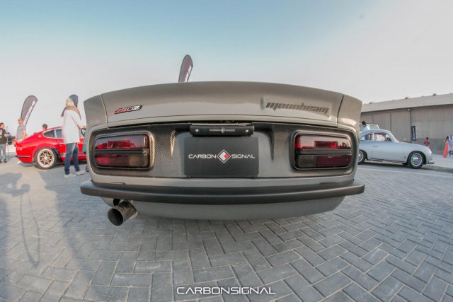

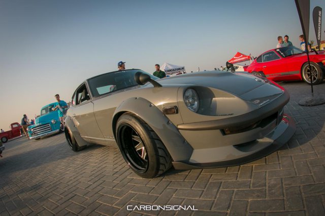

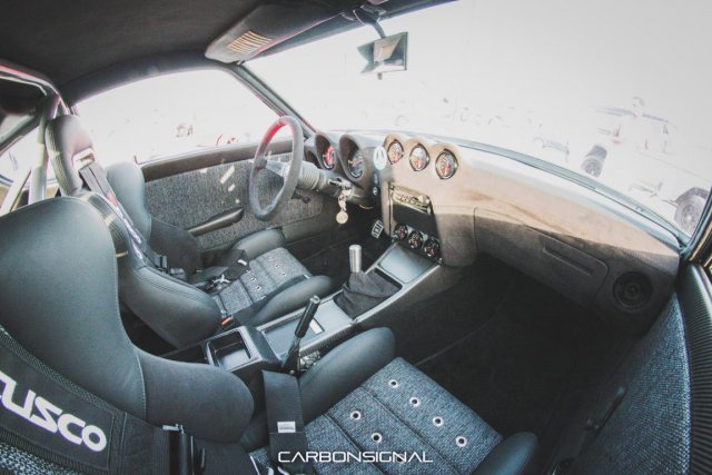

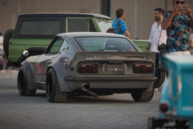

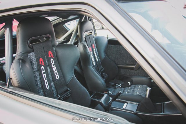

Made the VQ35 run, installed our Moonbeam Gnose version kit similar to what was installed on Chris Forsberg car last year SEMA and redid the interior, went a bit long way apart from normal interior pieces which carbonsignal made we made other rear ones and roof panel as well, from the molds all done in carbon fiber. Installed a custom roll bar, door panels, and dashboard done in FRP wrapped in leather and Alcantara and redid old Bride seats in similar material. Installed new CS design gauges will post pics later from closeup.
Wheels were done new worked with SevenK do design something similar to Equip and SSR mix of both in 16x10' and16x11"
