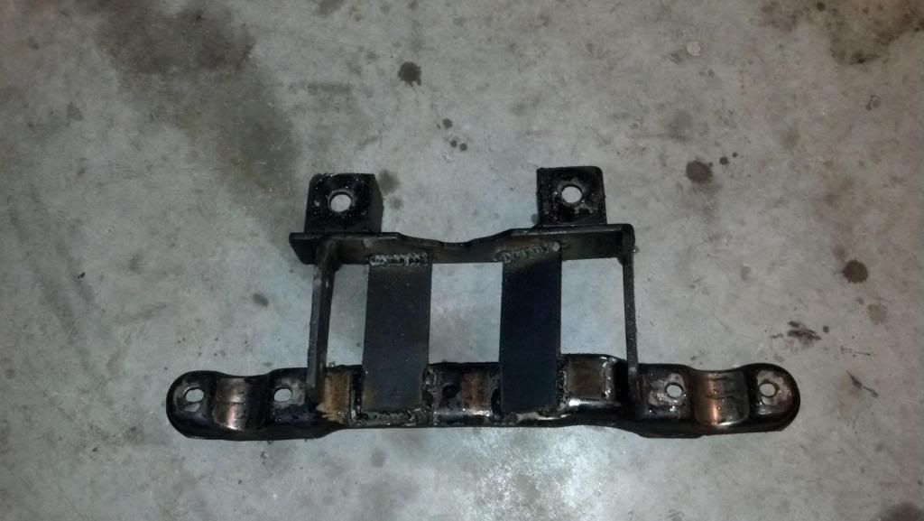

SUNNY Z Posted July 11, 2013 Author Share Posted July 11, 2013 (edited) This is the solution to my diff mount loosening itself. 2 pieces of 1/4"x 2" strap welded to the crossmember. Seems to have eliminated my nasty 2nd gear wheel hop as well. I hope I don't have to take it out, because it was a PITA to put in..... even on my buddy's lift. Edited July 11, 2013 by SUNNY Z Quote Link to comment Share on other sites More sharing options...

jnjdragracing Posted July 11, 2013 Share Posted July 11, 2013 This is the solution to my diff mount loosening itself. 2 pieces of 1/4"x 2" strap welded to the crossmember. Seems to have eliminated my nasty 2nd gear wheel hop as well. I hope I don't have to take it out, because it was a PITA to put in..... even on my buddy's lift. Looks meaty enough, great idea. Quote Link to comment Share on other sites More sharing options...
SUNNY Z Posted September 29, 2013 Author Share Posted September 29, 2013 Looks meaty enough, great idea. This bracing helped greatly, but made it a huge PITA to put in. Also, I noticed the last time i put it in that there is still a substantial amount of flex in this mount setup. I plan on making a new cage for this diff over the winter, and including more body mounting points to hopefully make it solid! Quote Link to comment Share on other sites More sharing options...

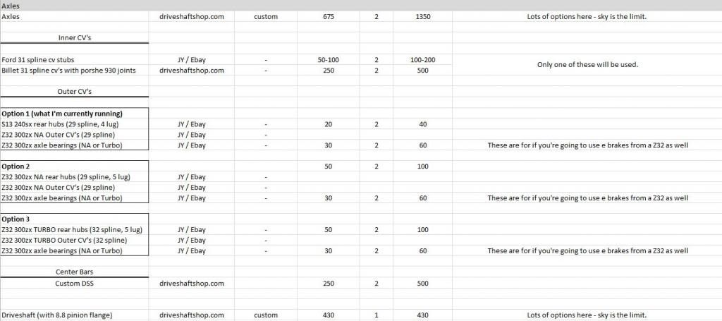

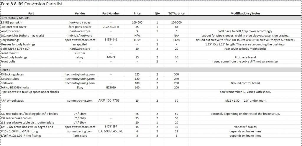

SUNNY Z Posted February 11, 2014 Author Share Posted February 11, 2014 Just so everyone has access to this (unless my photobucket crashes) I'm going to post these here. The formatting is a PITA to get from excel to look right. If you want the spreadsheet, I'll email it to you, just PM me. I'd suggest saving these..... Quote Link to comment Share on other sites More sharing options...

Gollum Posted February 12, 2014 Share Posted February 12, 2014 Just so everyone has access to this (unless my photobucket crashes) I'm going to post these here. The formatting is a PITA to get from excel to look right. If you want the spreadsheet, I'll email it to you, just PM me. I'd suggest saving these..... For future record, I've got them saved now, and I'm the type that backs things up like a paranoid conspiracy theorist. Oh, and thank you for all your hard work. This is a serious contribution to the community that seems all too rare. For the 240z side of that question, I have separated the floor/tunnel seam at the back of the floor over the diff. I have cracks in my a-pillars and c-pillars but those existed before the swap. When I launch hard, the rear upper corner of my doors slaps the door frame and chips the paint occasionally. Other than that, I'm good for the moment. Intense! Overall that's pretty impressive I think. It's always a good sign you've engineered your drivetrain well when the chassis becomes a limiting factor... Quote Link to comment Share on other sites More sharing options...
