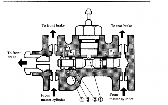

redzedturbo Posted November 29, 2012 Share Posted November 29, 2012 Okay so when i bought this car it had no brakes. (83 turbo 280zx) After new pads rotors calipers and master and booster. Viola now i have brakes. The issue at hand is the car does the majority of its braking from the rear. A lady pulled out in front of me yesterday and when she finally noticed her stupidity she just froze and stopped in the middle of the road this forced me to get on the brakes in a rather hastily manner. The car locked the rear wheels and swings the tail out! At this point i had to pull a formula D maneuver and clutch kick down shift to slide around her. This whole situation could have been avoided if my brake bias was correct. Now you know the story if some one knows how to reset a prop valve or clean it to make it work properly please chime in....... Quote Link to comment Share on other sites More sharing options...
motomanmike Posted November 29, 2012 Share Posted November 29, 2012 Is there any chance you are feeding fluid to the front and rear in a different manner than before. Did you just change the master cylinder? Also, was it the correct master cylinder for your 280zx? Quote Link to comment Share on other sites More sharing options...
redzedturbo Posted November 30, 2012 Author Share Posted November 30, 2012 Stock turbo master. I am going to take the prop valve off this weekend and try to center the ball inside. Also i looked at my friends 240z and he is running the same master as me, the lines are run the same. So i think its gotta be the prop valve. THANK YOU NISSAN FOR DISCONTINUING OUR PARTS! Quote Link to comment Share on other sites More sharing options...
Miles Posted November 30, 2012 Share Posted November 30, 2012 Center the ball? Are you thinking of the brake differential pressure switch? See picture. There could be other reasons besides the proportioning valve that caused the rear brakes to lock. Quote Link to comment Share on other sites More sharing options...
Xnke Posted November 30, 2012 Share Posted November 30, 2012 Yes, that is what he is referring to. On the S130 I'm told that it also contains the proportioning valve. If it doesn't, then that particular car DOESN'T have one installed...there's nothing between that block and the rear brakes but a 'T' fitting right before the line splits to feed the left and right calipers. As far as either of us can tell, it's all factory installed lines...we certainly haven't replaced any of the hardlines. Quote Link to comment Share on other sites More sharing options...
motomanmike Posted November 30, 2012 Share Posted November 30, 2012 Do the rear brakes release without any binding once they lock? Have you verified that with the car lifted up? Quote Link to comment Share on other sites More sharing options...
NewZed Posted November 30, 2012 Share Posted November 30, 2012 My 76 did the same thing after I got it road-worthy. The PO had installed the calipers on the wrong sides, with the bleed valves low instead of high. Poor brakes in general, the brake light would go on when the brakes were used due to the pressure imbalance from the big air bubble in the fronts, and the rears would lock if you pressed hard enough. Quote Link to comment Share on other sites More sharing options...
Gollum Posted December 1, 2012 Share Posted December 1, 2012 Yea, I'd be looking for air in the front or something else gone wrong up there. Verify front system first. It COULD be the prop valve, but I just don't hear many stories of those going bad unless being left in the elements. Quote Link to comment Share on other sites More sharing options...
