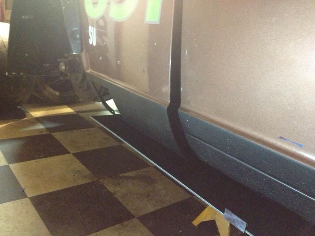

heavy85 Posted March 9, 2014 Author Share Posted March 9, 2014 (edited) Version 2.0. The first ones I did were just straight down but they dragged on the trailer, had to remove to jack the car, made it harder to climb underneath, and were just a PITA. Neither lap times nor seat of the pants told me they did anything. So now I've added a flap in front of the rear tire and tied in a horizontal skirt. Also pulled the front fender out at the bottom so air in the wheel well can spill out on top of the skirt. We will see how this works. Edited March 9, 2014 by heavy85 Quote Link to comment Share on other sites More sharing options...
Sideways Posted March 10, 2014 Share Posted March 10, 2014 Version 2.0. The first ones I did were just straight down but they dragged on the trailer, had to remove to jack the car, made it harder to climb underneath, and were just a PITA. Neither lap times nor seat of the pants told me they did anything. So now I've added a flap in front of the rear tire and tied in a horizontal skirt. Also pulled the front fender out at the bottom so air in the wheel well can spill out on top of the skirt. We will see how this works. Looking quite interesting. What material did you use? Quote Link to comment Share on other sites More sharing options...
