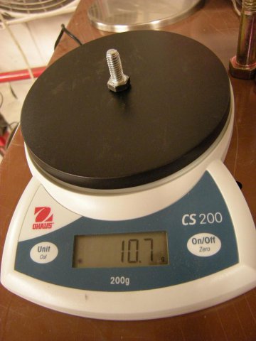

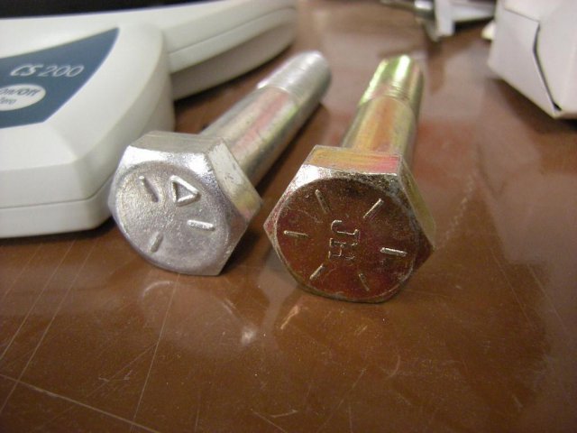

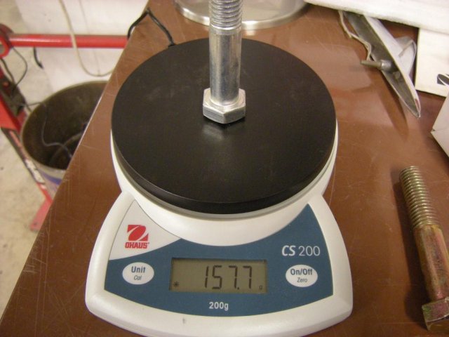

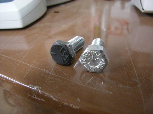

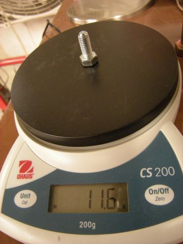

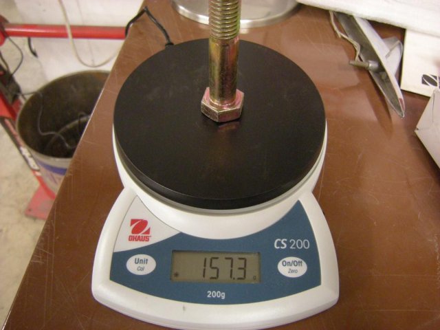

Snailed Posted January 20, 2013 Share Posted January 20, 2013 RebeccaZ, you made me curious. I'm down at the shop working on my Z and I just had to weigh some bolts (we have a huge stock of new hardware on hand). I had trouble finding many grade 5s in the exact same configuration as the 8s. Some had thicker heads or a slight taper before the threads start, etc. I couldn't find any metric bolts in different grades that matched, we don't have as many metrics unfortunately. We have lots of stainless bolts too if anyone wants weights for those... First, I weighed two 5/8" x 3.5" bolts on a digital scale. One grade 5 and one grade 8. Except for the platings and the marks on the heads, they were identical. The 5 weighed 157.7 grams and the 8 weighed 157.3 I also found two 5/16" x 1" bolts but the 8 had a taller head. The 5 was 10.7g with the thinner head and the 8 was 11.6g My conclusion is that there is no real difference that would add up to more than a gram or two on a whole vehicle Time would be better spent cutting off unused threads and swapping in slim nuts where it was safe. Changing to aluminum bolts works in some places too. Quote Link to comment Share on other sites More sharing options...
Snailed Posted January 21, 2013 Share Posted January 21, 2013 I took pictures for anyone interested. 1 Quote Link to comment Share on other sites More sharing options...
