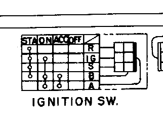

There are a pair of loose (red? red-black?) wires that hang off the side of the ignition switch that are part of the interlock. ie when you turn to the lock position these wires either get connected or disconnected. Makes the seat belt buzzer go off or something.  If you have mistakening used these wires in another way, then this might be why turning your key to lock has an electrical result you aren't expecting.

Well, the issue has to be with those wires. The white and the White/red I think you have this confused.  The white and white/red should be connected together. in the AMP meter, they show the current running to the battery, either a positive draw or a negative draw. current has to run through it to get a reading.  The Volt meter is different, If just measures if there's voltage on the line.  So you'll have to verify this, but it seems if you connected the two wires together, then connected one of the terminals, then connected the other to ground you shoudl read volts.  This should be switched power, so while key is off it should not be reading power.  otherwise you'd have to find a different connection to use for the switched power.  there's probably a thread on this, Voltmeter installation.

On the 240z tach, the ignition wire runs through it so maybe the issue is there. If not get a new ignition. I had similar issues and after replacing the ignition, it was fine. This is where I got mine and its a quality piece
