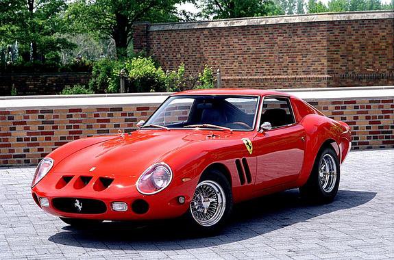

SpeedRacer Posted August 27, 2013 Share Posted August 27, 2013 John Washington from Reaction Research http://www.reactionresearch.com/automotive.html has been making and selling the VeloRosa (Ferrari GTO spyder) kit for the Datsun Z car for years. Give John a call. Not only is he a great guy but he knows a great deal about convertible Z cars. I believe he sells a reinforcing kit that fits entirely within the cockpit and does not require a roll bar. Quote Link to comment Share on other sites More sharing options...
