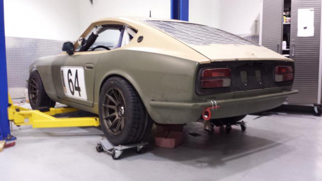

This is a "ChumpCar" enduro racer.. I'm having so much trouble with finding wheels that will fit.
Here's what I'd like
http://www.teamdynamicsracing.com/pro-race/Pro-race12.htm
These are light, not super expensive and look decent. They come in 4x114.3 17x9 E+23. Fender clearance is NOT an issue, the car is about to undergo a custom home widebody job. No big deal here. But spring clearance is an issue. The car has MA offset control arm bushings front and rear for additional camber and Tokico HP springs/struts, so it's lower than stock. We've also notched the strut towers for a bit extra camber. I don't think this wheel will fit. I'm showing a necessary backspace of <4.2 inches to clear our spring and these wheels have a backspace of 150mm, or 5.2 inches.
I also found the Rota RBX on their website but it seems like no one stateside stocks these wheels. They're only available on the UK website.
The trouble is that NO ONE makes a fairly inexpensive wheel that fits the Z anymore from what I can tell, all the wheels now have positive offsets and we need an even or negative offset to fit the Z. I almost don't even care what it looks like as it's for a race car, but they have to be 16x9 or 17x9 and they have to fit WITHOUT spacers (I'm not comfortable running spacers on an endurance race car that will be out on the track for 2 hours at a time for a total of 24 hours).
Any suggestions on where to go now? I've found some wheels but they're all $500+ per corner.. the car is only supposed to cost $500, so I'd rather not drop that much.  Thankfully, wheels are "open" on the OBCCWS rules - I guess they figure if anyone is dumb enough to show up and race a $2000 set of wheels that probably will get scuffed and damaged, they don't care.. lol.
Budget is in the <$250/each range. (TDM and Rota both fit this but from what I can tell both wheels are questionable fits. And yes I have searched..for the past three days! Even went through the 40-page wheel thread, but most people there either have $500+/each wheels or are running spacers.
Any suggestions?
Well, we can't run slicks - TW limit is 180. Really the only way to squeeze more lateral grip is to go wider. We're running 16x7 Rota RBs right now with 225 width tires. I'd like to step up to 245 or 255 if possible. Fender clearance is NOT an issue, but spring clearance is.
Also, this car has a 3.70 rear end with a stock 4-speed so there is a minimum size that we can use before we start hitting the rev limiter on the straights.. right now the car tops out at about 126-128 MPH. Any smaller wheels and we'd drop that down too much.
