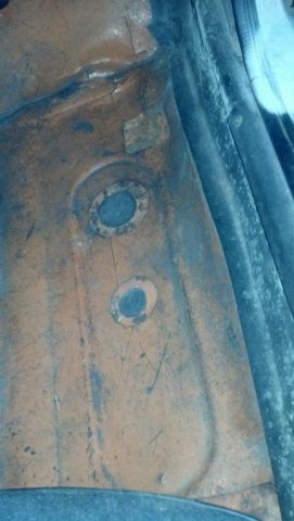

seattlejester Posted December 31, 2013 Share Posted December 31, 2013 Hmm, the fact it is very humid could very well be concerning. Painting over the insulation with por15 won't be doing much, it would just be protecting the exposed bits. I guess it would be sealing the floor and the insulation together to prevent any further moisture, but that won't stop any preexisting rust from eating away. As mentioned, if they are mint, then it doesn't need to be removed since there would really be no net gain, but considering it is a 40 year old car it may not be as mint as you think they are. Any pictures? Quote Link to comment Share on other sites More sharing options...
daddydonuts Posted December 31, 2013 Author Share Posted December 31, 2013 It's still the original color from the factory. I am going to remove the insulation then treat it. Quote Link to comment Share on other sites More sharing options...
daddydonuts Posted December 31, 2013 Author Share Posted December 31, 2013 Hmm, the fact it is very humid could very well be concerning. Painting over the insulation with por15 won't be doing much, it would just be protecting the exposed bits. I guess it would be sealing the floor and the insulation together to prevent any further moisture, but that won't stop any preexisting rust from eating away. As mentioned, if they are mint, then it doesn't need to be removed since there would really be no net gain, but considering it is a 40 year old car it may not be as mint as you think they are. Any pictures? They are solid...but I do need to remove it to prevent any rust...thanks for the advice Quote Link to comment Share on other sites More sharing options...
