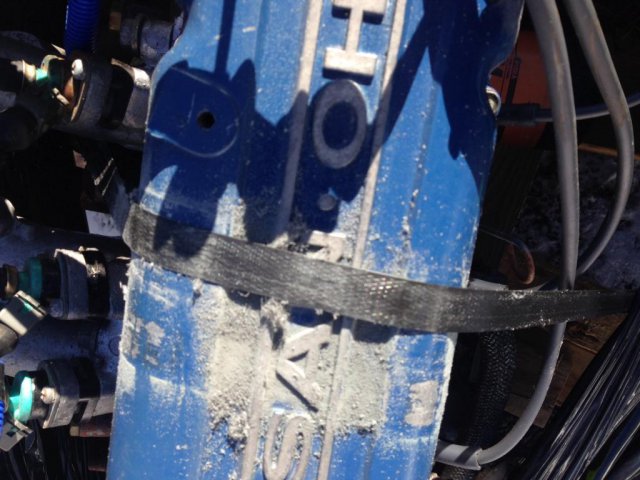

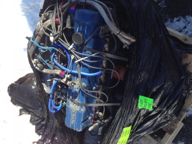

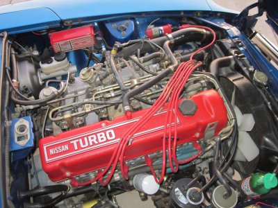

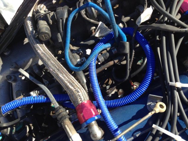

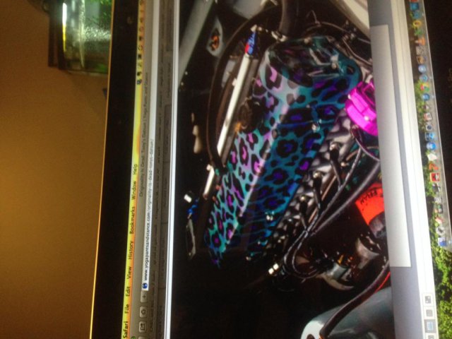

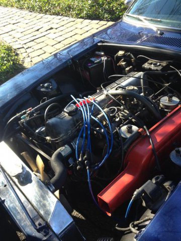

nzarano Posted January 30, 2014 Author Share Posted January 30, 2014 (edited) realized i haven't even gotten pics of the l28 up so here's what I've got... engine has cut up wiring and is missing it's ecu and maf/intake but those parts are on the way... also saw this online and was quite interested….. id love to have an engine bay that clean swell as a painted (I'm assuming is hydrographics? but i have no clue..) valve cover thats original….anyone have tips for keeping an engine bay that clean? Edited January 30, 2014 by nzarano Quote Link to comment Share on other sites More sharing options...
clocker Posted February 1, 2014 Share Posted February 1, 2014 ….anyone have tips for keeping an engine bay that clean? To keep it clean you have to start with it clean and IMO, that requires as total a stripdown as you can bear. Since you'll be pulling the engine, you're already halfway there. POR15 or bedliner are popular choices for the bay if you don't want to go body color paint; their thick matte finish covers myriad flaws and makes a nice background to feature the engine. My approach to the engine bay as a whole is to keep everything at about the same level of finish. To me, nothing looks more jarring than shiny/obviously new parts juxtaposed with older/janky hardware...the new stuff just emphasizes how bad the old looks. This came from a lesson I got from a pro polishing guy...he did nothing but metal finishing, everything from Harley parts to antique clocks. He would study the part and pick the hardest area to begin with. Do as best he could there and then bring the rest to that level, but not beyond (even though some places could get much shinier). The final finish might be less than ideal but the overall appearance was actually better because there weren't any obvious "bad spots" where it looks like you gave up or failed. Basically, it's the application of the test pilot motto "Maintain an even strain" to engine bay aesthetics. Viewed as a whole, the valve cover is the obvious centerpiece of the bay. (I'll admit a bias here...if the car is carbed, the whole cover and intake area shares interest but I think the stock FI setup is lumpen and ugly and chose to minimize it's look on my engine) So go ahead, visualize how you want to treat the valve cover- polish, paint, camo...doesn't matter. Now, everything else in the bay has to look that good. Not necessarily the same finish of course, but the same amount of attention paid to them. I find that an easy way to approach this daunting task is to get very up close and personal right at the beginning. Sit in your engineless bay, start at some logical place and start unbolting everything you can get to. Remove a bolt, run a tap through the capture nut, replace the bolt. The Z bay has A LOT of hardware. When you're done, you know where everything is and have probably discovered a few things you didn't know existed. You've also probably had to fix some broken bolts along the way...your future self will thank you. You've also gotten hands and eyes on every nook and cranny, so you know exactly where you stand. How you proceed from there depends on ambition, budget and resources. If, for whatever reason, you're not willing to commit to a full strip and clean/paint right now, I'd urge you to resist the temptation of a quick and dirty (usually flat black) rattle can job. It will only look "good" temporarily and just means more cleanup later. Better an honest shabbiness than lipstick on a pig. My $.02. Quote Link to comment Share on other sites More sharing options...
