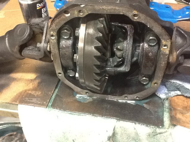

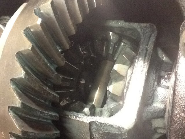

12doplumbing Posted April 28, 2014 Share Posted April 28, 2014 Is this R200 an LSD? It has stampings indicating its a 3.9 ratio. We went to service / change oil, after confirming gear ratio, and found the inner gearing/rings were welded. Looks like a good weld job; done in four places from what I can see through the opening -- on each half shaft spline ring and on each middle bridge ring. Was this to get rid of the LSD headache? Some youngster wanted to peel out/drift easier? Appreciate pros and cons and suggestions. Like, should I just restore what was here? Is it hard to swap this internal setup for 3.7 gearing? Costly? Quote Link to comment Share on other sites More sharing options...
rturbo 930 Posted April 28, 2014 Share Posted April 28, 2014 (edited) Some youngster wanted to peel out/drift easier? That's about right. IMO a welded diff is worthless. Your diff is not an LSD, and welding the diff is a very cheap way of making it into one. The downside is that the wheels can't turn independently anymore. Edited April 28, 2014 by rturbo 930 Quote Link to comment Share on other sites More sharing options...

Six_Shooter Posted April 29, 2014 Share Posted April 29, 2014 I have no idea what being an IRS vs a live axle has to do with anything...Also welding a diff does not turn it into an "LSD", It does however have the same effect as a spool. LSD still allows for each wheel to turn independently, such as when turning a corner. A spool does not, both wheels are locked together. You will usually feel one tire dragging and the car act a bit funny when turning a corner, with a spool. These are often referred to as "Lincoln Lockers". I've seriously considered doing this to mine, since I refuse to pay the ridiculous prices for an R200 LSD. I haven't yet and will likely swap in a different diff, to get a cheaper (and possibly better suited) LSD and diff. Quote Link to comment Share on other sites More sharing options...

osirus9 Posted April 29, 2014 Share Posted April 29, 2014 Lots of drifters weld their diffs. It's the cheapest and easiest way to get more traction in the back wheels. The downside is already explained here... Your "regular" turning ability is decreased because the wheels are locked together. This will make your rear end squirrelly in corners (which is intentional on drift cars), but is pretty annoying in a daily driver. You'll also get dumb stuff like the wheels chirping in the back as you take a corner at 3mph in the parking lot. If you're not putting down lots of power, or drive normally and never race, stick with the open diff. If you find yourself making "one tire fires" then go get an LSD. Quote Link to comment Share on other sites More sharing options...
