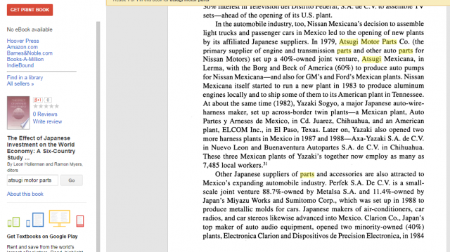

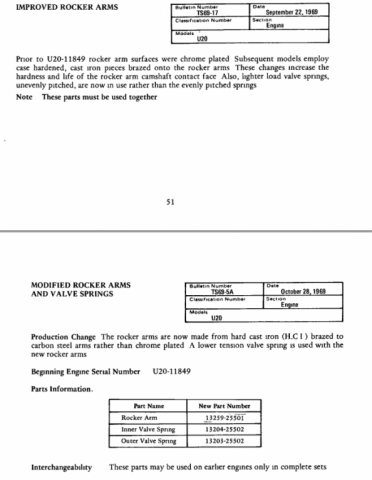

NewZed Posted October 2, 2014 Author Share Posted October 2, 2014 Looks like they are a low-profile supplier to Nissan, if the attached reference is correct. There's not a lot out there about them in English. If a person really wanted to take care with their new camshaft, the Paraut brand might be worth the extra money over ITM. Nissan used to chrome plate the early rocker arms but changed in 1969. Attached a Technical Bulletin copy. Seems like maybe they've always been a little bit problematic. Japanese Atsugi page: http://ejje.weblio.jp/content/ATSUGI+MOTOR+PARTS+Co.,Ltd. Quote Link to comment Share on other sites More sharing options...
