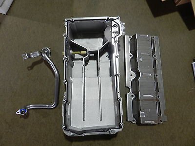

stony Posted November 26, 2015 Share Posted November 26, 2015 LS3 C6 pan. found a complete kit on ebay for around 400. it had everything, windage, gasket, hardware. Basically everything you need to install. The baffling is really good considering its a stock pan. Quote Link to comment Share on other sites More sharing options...
stony Posted November 26, 2015 Share Posted November 26, 2015 Here is a pick of the pan. Quote Link to comment Share on other sites More sharing options...
Stock Car Mafia Posted November 27, 2015 Share Posted November 27, 2015 I wonder if there are a couple different versions of pickup tubes that can be used. I see a blue O-ring on yours. Can you verify if the o-ring seat is tapered or straight? I used a red O-ring with mine and it fit nice and snug in the oil pump, so I know it is the right one. Quote Link to comment Share on other sites More sharing options...
stony Posted November 30, 2015 Share Posted November 30, 2015 That was the pic from where I bought it. forgot to take pics. Came with instructions and 2 different o rings. Quote Link to comment Share on other sites More sharing options...
