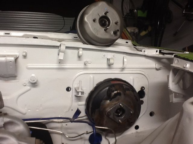

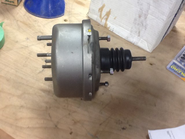

12doplumbing Posted April 2, 2015 Share Posted April 2, 2015 Help: I bought this booster which was listed as fitting my '72 but it's much smaller than what I believe is factory: I purchased from Auto Parts Warehouse -- couldn't seem to locate anywhere else. Any thoughts? Everything looks like it's in the exact position as factory, just the housing itself is smaller. Quote Link to comment Share on other sites More sharing options...
SleeperZ Posted April 2, 2015 Share Posted April 2, 2015 So it should fit without any problem, right? Quote Link to comment Share on other sites More sharing options...
12doplumbing Posted April 2, 2015 Author Share Posted April 2, 2015 Yes. I mounted it and vacuum port, bolt studs -- everything is identical. Quote Link to comment Share on other sites More sharing options...

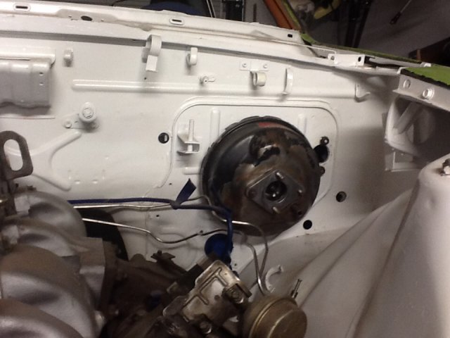

12doplumbing Posted April 2, 2015 Author Share Posted April 2, 2015 That's the factory one held in place, not the new one... Quote Link to comment Share on other sites More sharing options...
Kevin.pk Posted April 2, 2015 Share Posted April 2, 2015 The original one you had in the car is actually a larger 280z booster that a previous owner may have installed at some point. The smaller booster is actually correct for the stock 240z booster. http://forums.hybridz.org/topic/99516-240z-vs-260-280-z-pedal-assemblies/?p=933168 Quote Link to comment Share on other sites More sharing options...
Tank Posted April 2, 2015 Share Posted April 2, 2015 ^ Second that Quote Link to comment Share on other sites More sharing options...
casper9182 Posted April 2, 2015 Share Posted April 2, 2015 3rd that. Do you have stock brakes? Quote Link to comment Share on other sites More sharing options...
12doplumbing Posted April 2, 2015 Author Share Posted April 2, 2015 Yes; sort of stock... Front disc, rear drums. Then stock slave -- abandoning stock pressure balancing valve and switch/light and installing manual adjustment valve. All else stock. So thank you! I was getting frustrated. Any concerns or further queries -- always appreciated Quote Link to comment Share on other sites More sharing options...

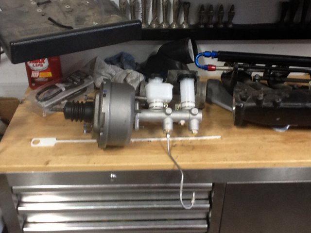

Miles Posted April 3, 2015 Share Posted April 3, 2015 The 280Z booster works well with the Wilwood 1 inch brake MC I installed when I did the Toyota front and 280ZX rear disk swap. Makes the brake pedal less stiff Quote Link to comment Share on other sites More sharing options...

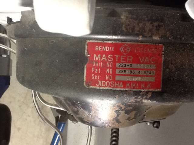

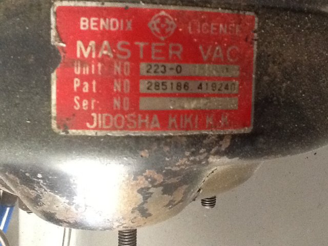

Nigel Posted April 3, 2015 Share Posted April 3, 2015 On 4/2/2015 at 3:01 PM, Kevin.pk said: The original one you had in the car is actually a larger 280z booster that a previous owner may have installed at some point. The smaller booster is actually correct for the stock 240z booster. http://forums.hybridz.org/topic/99516-240z-vs-260-280-z-pedal-assemblies/?p=933168 Not actually correct. Nissan started making changes to the brake system during 240Z production, including the larger brake booster. I don't know off hand exactly when the changes were implemented, but my '73 240Z has the larger booster, the later master cylinder, and the firewall mounted brake proportioning valve that are found on the 260Z and 280Z. It still had the earlier style drums though. Nigel Quote Link to comment Share on other sites More sharing options...
12doplumbing Posted April 3, 2015 Author Share Posted April 3, 2015 Here is the part info (looked pretty much untouched when bought; said not to have been run since the 80s): Quote Link to comment Share on other sites More sharing options...
Nigel Posted April 3, 2015 Share Posted April 3, 2015 On 4/3/2015 at 7:50 PM, 12doplumbing said: Here is the part info (looked pretty much untouched when bought; said not to have been run since the 80s): Exactly the same as my 240Z Quote Link to comment Share on other sites More sharing options...

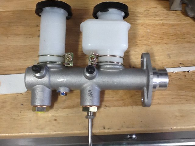

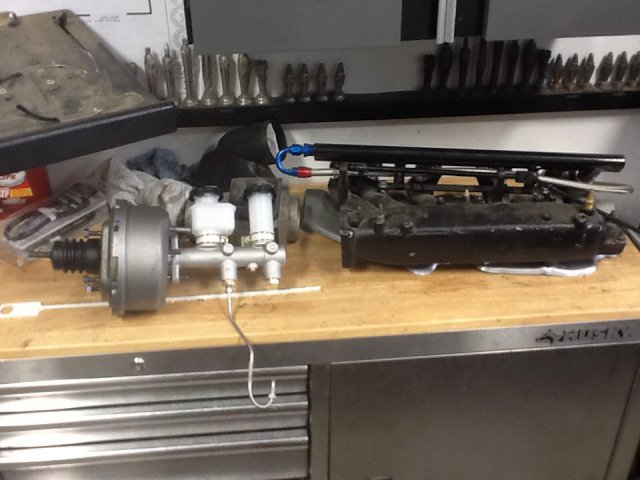

12doplumbing Posted April 3, 2015 Author Share Posted April 3, 2015 So I'm wondering what performance issues I may be dealing with, with this smaller booster.... All new SS lines, rebuilt front and rear to stock (disc front, rear drum) and new slave from Black Dragon Spacer isn't shown between slave and master, but it all lines up and seems to fit well. Quote Link to comment Share on other sites More sharing options...
