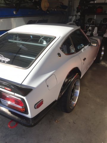

trackzpeed Posted February 7, 2018 Author Share Posted February 7, 2018 terrible phone pics but a here’s a couple of shots.... I short test drive indicates a much smoother and quieter ride. Car goes in for performance alignment on the rear Thursday. Quote Link to comment Share on other sites More sharing options...
trackzpeed Posted February 9, 2018 Author Share Posted February 9, 2018 Back on track with alignment done per HBZ sticky....... can’t wait to race again, get some tire temp, and do some fine tuning Quote Link to comment Share on other sites More sharing options...
trackzpeed Posted February 18, 2018 Author Share Posted February 18, 2018 all cleaned up up and ready for a race next weekend weather permitting. I’ll post video when I can. Quote Link to comment Share on other sites More sharing options...
