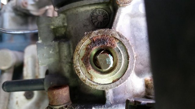

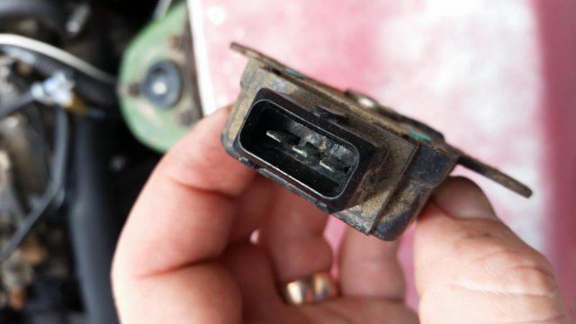

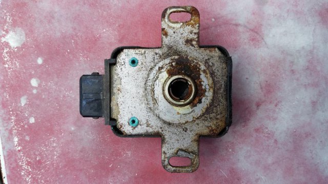

hwvigo Posted June 21, 2015 Author Share Posted June 21, 2015 (edited) Wild guess TPS should not be filled with oil and water! Guess I'm ordering a new one. Also changed fuel filter. And all lines to 3/8th no change in problem still have not pulled the pump or checked fuel pressure. Edited June 21, 2015 by hwvigo Quote Link to comment Share on other sites More sharing options...
