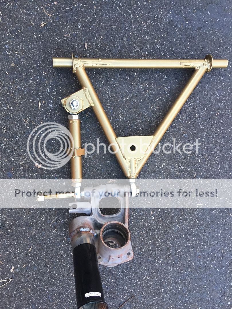

seattlejester Posted February 7, 2016 Author Share Posted February 7, 2016 So I am coming into this realizing I really don't know very much. First off, finished product: Powdercoating place did real well. Something I am struggling to understand however is the forward to aft movement. Video for reference. http://s639.photobucket.com/user/jesterjin/media/55A5E42F-991B-43B4-9EA8-D9BE273EB65A_zps0fzomrxj.mp4.html?o=0 With the axle and the strut installed is there enough rigidity in those two axes to prevent that twisting motion? I think TTT arms prevent this by having a fixed distance between the toe link and the A arm. Am I missing something here? Or is this how it is supposed to work? Quote Link to comment Share on other sites More sharing options...
JMortensen Posted February 7, 2016 Share Posted February 7, 2016 The strut top is in a fixed position and that's what holds the strut tube vertical. The difference between this design and mine with the toe link at the front is that the strut tube is on top of the rear pivot, so a simple push up or down on the hub (where the forces affect the suspension as the car goes over bumps and rolls) doesn't put a pivoting force (side load) on the strut tube as you show there if the toe link is in front. A solid control arm will deflect and that also puts load on the strut. The rear toe link design will put side load on the strut. The front toe link should put less than either because a vertical push to compress the strut won't twist things up as much. Check out posts 26 and 27: http://forums.hybridz.org/topic/62776-yet-another-rear-control-arm-design/page-2 Quote Link to comment Share on other sites More sharing options...
seattlejester Posted February 8, 2016 Author Share Posted February 8, 2016 I see, I guess I got mixed up with 240zdan's recent thread calling for a pillow ball mount in the back as well. So the strut top is fixed and keeps that plane locked. I'm going to have to look into more of the difference between the front and the rear toe link, I fear I'm still a bit lost. I will pour over your thread and the thread you linked once more. Quote Link to comment Share on other sites More sharing options...
JMortensen Posted February 8, 2016 Share Posted February 8, 2016 There are a lot of guys running what you have. I haven't seen anyone else doing it my way. I wouldn't stress too much over it. The main issue is that if you lift straight up on the hub, yours will pivot forward, mine won't (as much?). Probably splitting hairs... Quote Link to comment Share on other sites More sharing options...
seattlejester Posted February 8, 2016 Author Share Posted February 8, 2016 I can definitely see that, since for one thing your rearward rod end wouldn't have any play in it and your front one has a much shorter arm so it would deflect less. I wonder if on yours it would pivot backwards, granted the strut housing is right smack on top of the rear one so maybe not as much a concern. I think someone had a similar design as the one I ran except they used a solid bushing up front and two rod ends in the rear. I guess I won't know until it is on the car. Thanks for taking the time to sort me out, was pretty startled after I put it all together. Quote Link to comment Share on other sites More sharing options...

NewZed Posted February 9, 2016 Share Posted February 9, 2016 Seems like the floppy rubber inner bushings are what would allow the control arm to twist and side-load the strut. Delrin or metal would help lock that axis in place. It would then have more of that race car feel. Quote Link to comment Share on other sites More sharing options...
seattlejester Posted February 9, 2016 Author Share Posted February 9, 2016 I've got poly on the inner side, I couldn't quite figure out how to turn that into a solid bushing. Lots of adjustments will have to be made for iteration 2. Quote Link to comment Share on other sites More sharing options...
NewZed Posted February 9, 2016 Share Posted February 9, 2016 (edited) AZC's setup is essentially solid. Don't click on the link unless you have time and bandwidth, there seem to be a lot more pictures there now. I pulled one out. You could do similar but leave the rotating inner axis at its original position. http://www.arizonazcar.com/cars.html Edited February 9, 2016 by NewZed Quote Link to comment Share on other sites More sharing options...
seattlejester Posted February 9, 2016 Author Share Posted February 9, 2016 I thought with that style, they ended up adding a set screw to hold that original pivot in place as if it rotated at any time it would cause the arm length to shorten or lengthen. I suppose I could have a delrin bushing made up, but I've cracked a couple delrin pieces so I'm not sure if that would be the ideal component. I've seen steel sleeves that peaked my interest. Quote Link to comment Share on other sites More sharing options...

heavy85 Posted February 10, 2016 Share Posted February 10, 2016 On 2/7/2016 at 4:36 AM, seattlejester said: So I am coming into this realizing I really don't know very much. First off, finished product: Powdercoating place did real well. Something I am struggling to understand however is the forward to aft movement. Video for reference. http://s639.photobucket.com/user/jesterjin/media/55A5E42F-991B-43B4-9EA8-D9BE273EB65A_zps0fzomrxj.mp4.html?o=0 With the axle and the strut installed is there enough rigidity in those two axes to prevent that twisting motion? I think TTT arms prevent this by having a fixed distance between the toe link and the A arm. Am I missing something here? Or is this how it is supposed to work? What struts are you using as it apears you may have welded on an custom strut tube? Quote Link to comment Share on other sites More sharing options...
RebekahsZ Posted February 10, 2016 Share Posted February 10, 2016 I have run the solid/delrin bushings. They are fine in the front, but they are SO loud in the rear, under your arse. They sound like rocks in a barrel banging around. Forget driving on a gravel road and keeping your teeth in your head. I went back to poly. Quote Link to comment Share on other sites More sharing options...
seattlejester Posted February 10, 2016 Author Share Posted February 10, 2016 That's useful feed back. I have the poly so it wouldn't cost me anything to swap them over. Although I fear some of the clunking is caused by the poly being loose. Seems there is a little bit of space that lets the poly shift. The tubes are from the BC coilover conversion kit. Quote Link to comment Share on other sites More sharing options...
