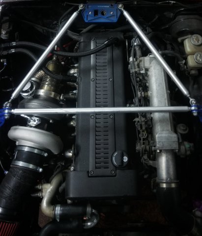

Exposed Posted February 22, 2018 Author Share Posted February 22, 2018 Thanks! I do abit of CAD sketchs for a couple firms occasionally so I get a bit of practice. Noticed I forgot to toss up a picture of the catch can mod a couple posts ago. Doesn't look to great but does the job. Quote Link to comment Share on other sites More sharing options...
Geno750 Posted February 23, 2018 Share Posted February 23, 2018 Nice progress! Given how minor that interference is, you can tap the turbo manifold runner in that spot to get the 1-2mm of clearance, or grind the stud down. Quote Link to comment Share on other sites More sharing options...
seattlejester Posted February 24, 2018 Share Posted February 24, 2018 I'd still like to see a bigger vacuum port, but that might just be nit picky. I know at work we have small lines pulling large volumes of vacuum. My recent mishap with AN fittings makes me a bit nervous with the boost solenoid, but that is probably a knee jerk reaction on my part. Quote Link to comment Share on other sites More sharing options...

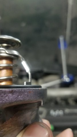

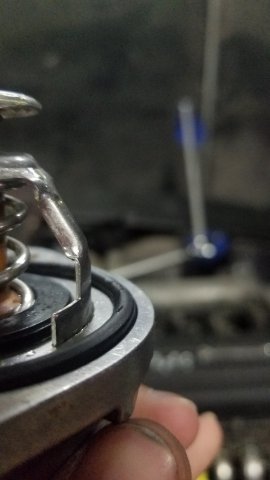

Exposed Posted February 25, 2018 Author Share Posted February 25, 2018 I ended up switching the gasket on the mishimoto thermostat and its fixed my leaking issue for the time being. For anyone thinking of using a mishimoto thermostat check your gasket height. I bought a different gasket from the local parts source, its a "Fel-Pro" gasket and the part number is "16325-62010". Mishimoto thermostat with Mishimoto gasket Mishimoto thermostat with Fel-Pro gasket Quote Link to comment Share on other sites More sharing options...
