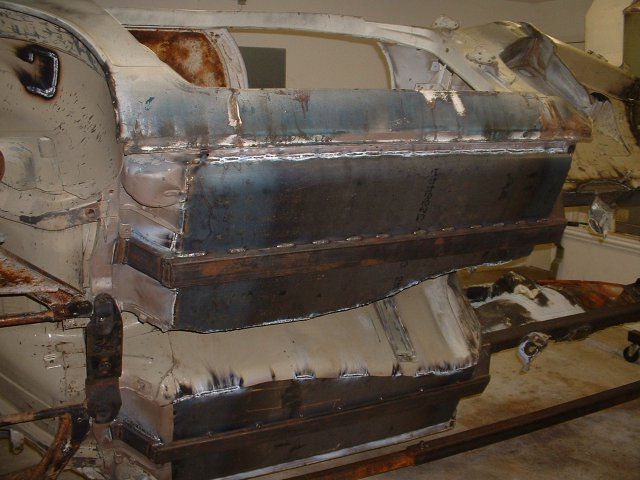

TUME Posted March 21, 2018 Share Posted March 21, 2018 I did my frame rails 30x60mm square tube. But my rails are partly inside car, floor pan is welded to rail sides. Look at my build topic, if it's working.... Quote Link to comment Share on other sites More sharing options...

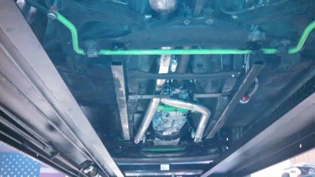

G-Tech Posted March 21, 2018 Share Posted March 21, 2018 i have a s130 which is always different than the older z's but i made my own frame ties by welding stainless 1x3 to the bottom of the frame rails. welded one end to the front main engine bay frame rail and connected them to the rear subframe. i have been beating on the car with a LS swap for 10yrs and they held the car nice and straight. Quote Link to comment Share on other sites More sharing options...

G-Tech Posted March 21, 2018 Share Posted March 21, 2018 (edited) Didn't see the need to cap the end off the back, maybe you can't see it but there a block welded to the subframe that drops down and welded to the top of the bar... the front is angle cut and hammered up so it's wedge shaped...I have heard the same about stainless welded to steel but we Did use stainless wire ,primed and seem sealed it and it's been good for 10yrs. I'm always under the car doing things and would see if there was issue...its what we came up with for frame ties and I'm happy with them. Every time the car has been dynoed they use them for strapping the car down even. Edited March 21, 2018 by G-Tech Quote Link to comment Share on other sites More sharing options...

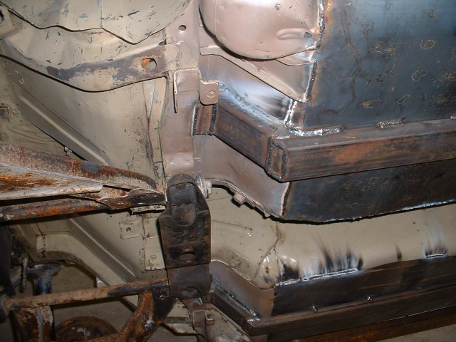

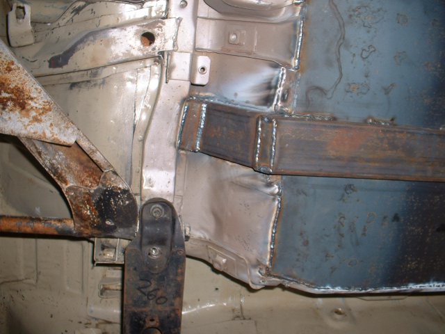

Jeff Posted April 4, 2018 Share Posted April 4, 2018 I did 1x3 subframes on mine but also replaced the floor pans with custom built ones that are flat on the bottom. I replaced the front frame rails with 2x2 as well so the front tie in is different from stock rails. Here's what mine looks like and we capped the open ends of the 1x3 with a piece of sheet metal welded solid. Quote Link to comment Share on other sites More sharing options...
