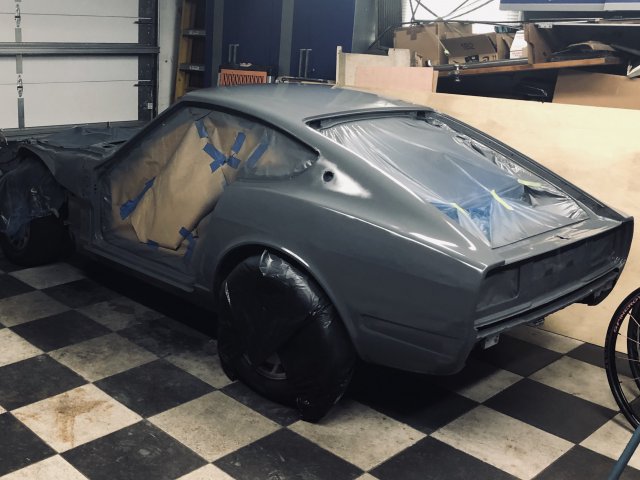

Jethoncho Posted January 6, 2019 Author Share Posted January 6, 2019 Put most of my bare metal in epoxy primer this week. No more chasing flash/surface rust. Not too bad for spraying in my rather dusty garage. Quote Link to comment Share on other sites More sharing options...

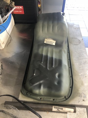

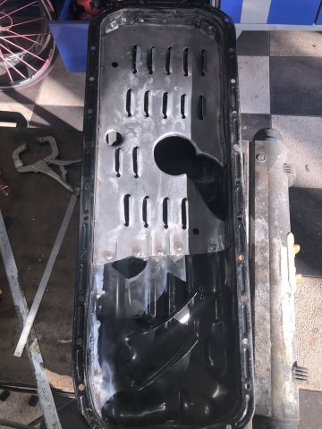

Jethoncho Posted January 8, 2019 Author Share Posted January 8, 2019 Today’s project was to fabricate a new windage tray for my modified oil pan. The oil pan is now complete except for leak check of all my welds. I ordered an extra pan gasket today, once that arrives I’ll bolt the pan down to the aluminum slab that I have then pressurize it through the drain hole and soap check the welds...once that’s complete I can finally close the lower end on my engine. Quote Link to comment Share on other sites More sharing options...
Jboogsthethug Posted January 9, 2019 Share Posted January 9, 2019 Man I'm happy to finally see some pics of someone actually going through this process, thanks for the great documentation! It all looks great! Are you going to swap the fins on the shallow pan to be the opposite direction? Or did you already do that? Quote Link to comment Share on other sites More sharing options...
Jethoncho Posted January 9, 2019 Author Share Posted January 9, 2019 On 1/9/2019 at 3:30 PM, Jboogsthethug said: Man I'm happy to finally see some pics of someone actually going through this process, thanks for the great documentation! It all looks great! Are you going to swap the fins on the shallow pan to be the opposite direction? Or did you already do that? Expand The windage tray I attached to the previous post from yesterday is a completely new fabricated part. The louvers are reversed from the original to compensate for the pan/sump being reversed. I’m gonna try to be a little more active with my post cuz I think it helps keep me motivated! Thanks for following my thread! Quote Link to comment Share on other sites More sharing options...

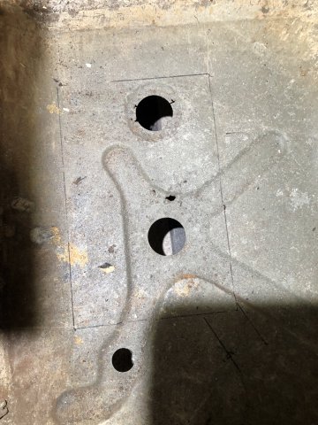

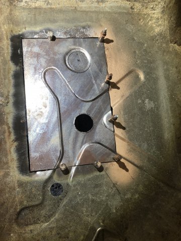

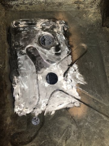

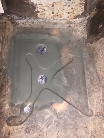

Jethoncho Posted January 9, 2019 Author Share Posted January 9, 2019 This morning’s project was the last bit of sheet metal work on the left side of the car. There was an area of damage/rust on the driver’s floor board. The area measured 11”x7” it it was right in the middle of the contoured pressed into the original floor board. This meant if I wanted to match the existing structure I would have to recreate these. I bought a bead roller from Jegs but since I’ve never used one before there was a bit of a learning curve. All in all I pleased with the results... Quote Link to comment Share on other sites More sharing options...
SleeperZ Posted January 9, 2019 Share Posted January 9, 2019 Wow, that's really impressive pattern matching. Quote Link to comment Share on other sites More sharing options...
Jethoncho Posted January 9, 2019 Author Share Posted January 9, 2019 On 1/9/2019 at 5:55 PM, SleeperZ said: Wow, that's really impressive pattern matching. Expand Thanks! Quote Link to comment Share on other sites More sharing options...

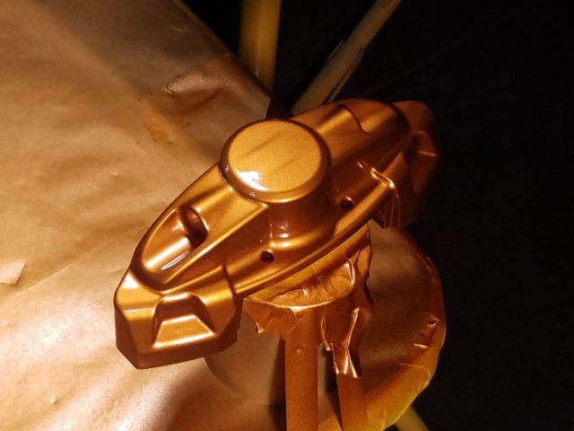

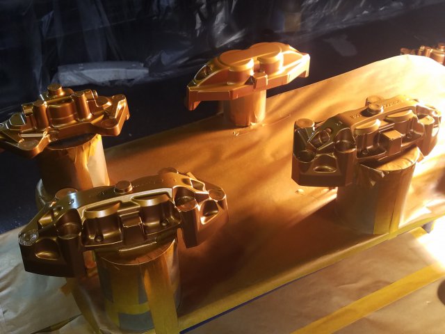

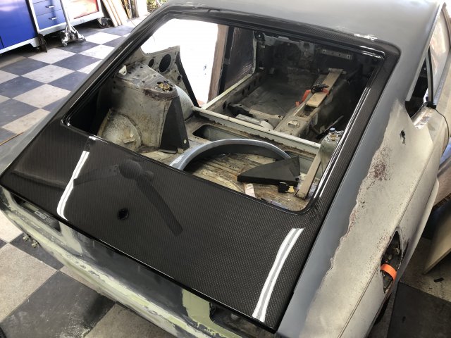

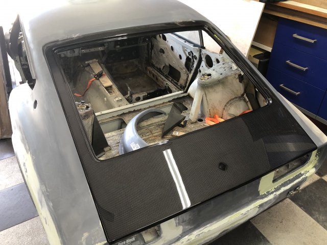

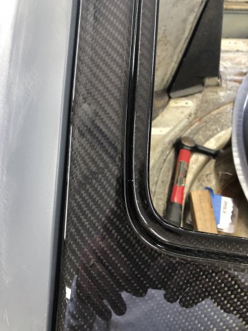

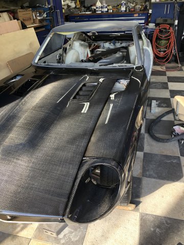

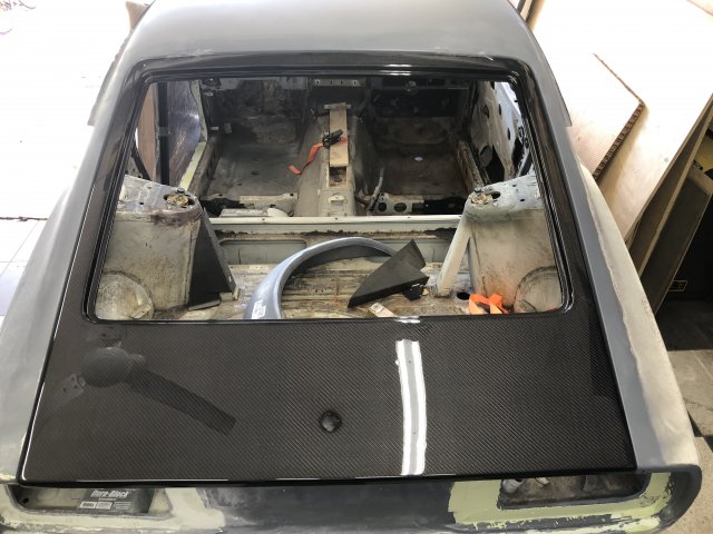

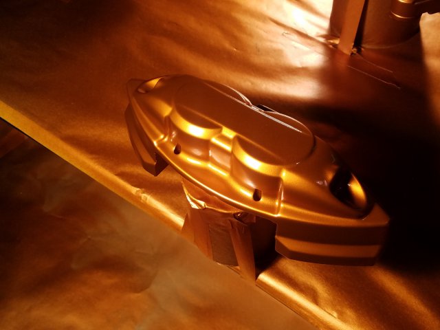

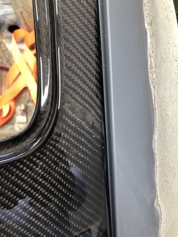

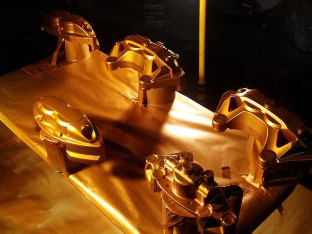

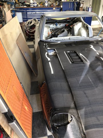

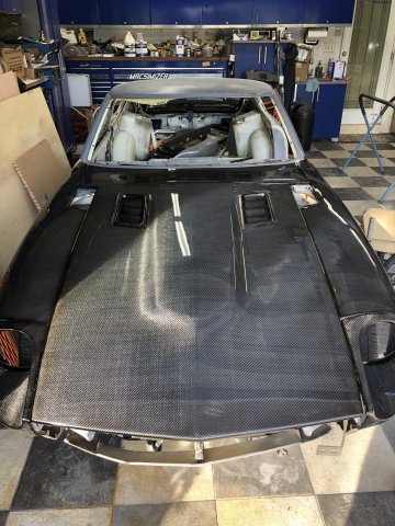

Jethoncho Posted January 29, 2019 Author Share Posted January 29, 2019 Yesterday the boxes from Retro-Spec Carbon started to arrive. The first box contained my rear hatch. I unboxed it and was happy to find it undamaged. The quality of the construction is very nice with on two very small areas noticeable in the weave where the cloth overlapped. Today’s delivery included the balance (hopefully) of my parts: hood, fenders, headlight buckets, front and rear BRE spoilers and wiper cowl. I’ll unbox on Friday when I return from work trip. I also received photos of my new calipers that are being color-match painted. Quote Link to comment Share on other sites More sharing options...
grannyknot Posted January 29, 2019 Share Posted January 29, 2019 Any idea how much weight savings you'll get with all those panels? Quote Link to comment Share on other sites More sharing options...
Jethoncho Posted January 30, 2019 Author Share Posted January 30, 2019 On 1/29/2019 at 11:24 PM, grannyknot said: Any idea how much weight savings you'll get with all those panels? Expand Haven’t weighed anthing yet bet the Carbon hatch is probably 15-20lbs lighter than the steel hatch. I’m guessing a total weight savings of 50lbs Quote Link to comment Share on other sites More sharing options...

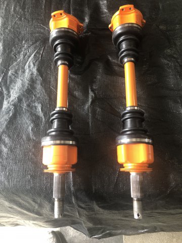

Jethoncho Posted February 5, 2019 Author Share Posted February 5, 2019 Today’s project was to build up my axles. After waiting a good length of time T3 got me the correct axles and CV boots for my differential conversion. I dismantled everything about two months ago. I painted all the parts yesterday...I also took the stub shafts out to the airport today to deal with the hammer damage from the hacks that removed the axles prior to my purchase. I put the stub shafts on the lathe and turned down the ends where the hack hammered them into submission. Then I returned home and assembled them. Quote Link to comment Share on other sites More sharing options...
Jethoncho Posted February 5, 2019 Author Share Posted February 5, 2019 Carbon was unboxed this past Friday . Quote Link to comment Share on other sites More sharing options...
Jboogsthethug Posted February 5, 2019 Share Posted February 5, 2019 Man it's turning out awesome! I'm jealous of all that CF! also, great job turning those axles, good as new! Quote Link to comment Share on other sites More sharing options...
Jethoncho Posted February 5, 2019 Author Share Posted February 5, 2019 On 2/5/2019 at 3:16 PM, Jboogsthethug said: Man it's turning out awesome! I'm jealous of all that CF! also, great job turning those axles, good as new! Expand Thanks! Trying to stay on track. Its a long road to go but the shiny bits help me stay motivated! Quote Link to comment Share on other sites More sharing options...
