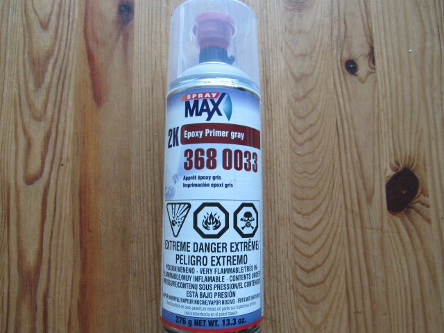

grannyknot Posted September 11, 2018 Share Posted September 11, 2018 Sorry Jugs but to do the job right you need to drill the spot welds out with a spot weld drill and remove the tray to get access to the rust underneath, otherwise it will just come back. Grind or sand back to clean metal and apply 2k epoxy primer and then paint. There are some good 2k primers in rattle cans now for small jobs like the battery tray area. Quote Link to comment Share on other sites More sharing options...

grannyknot Posted September 12, 2018 Share Posted September 12, 2018 22 hours ago, rturbo 930 said: Got a brand of primer/paint you like? Gonna be needing some soon. I like this suff, it says once it is mixed you have 4 days but if it is warm you get about 2 days. I have put a half a can in the fridge and it was still usable 10 days later. 6 hours ago, bunkhouse said: I'd treat the area with a rust converter after ridding the area of loose rust. Ospho (it will seep into the seams) is my favorite but any acid (muriatic is effective but extreme, phosphoric is better) will convert the rust. Then a zinc rich primer and on to paint. Muriatic doesn't convert rust, it removes it, then when it is rinsed off it will flash rust so fast you can watch it. Nasty stuff, I have never found a way to neutralize it, it seems to get into the steel and continue rusting under the primer. Phosphoric acid (Ospho) is the best to use. Quote Link to comment Share on other sites More sharing options...
LLave Posted September 14, 2018 Share Posted September 14, 2018 I have used the spay max epoxy. It works pretty well. A can doesn't go very far. Make sure you wear a real respirator. That is real 2k epoxy and would assume it contains ISOs. Quote Link to comment Share on other sites More sharing options...
