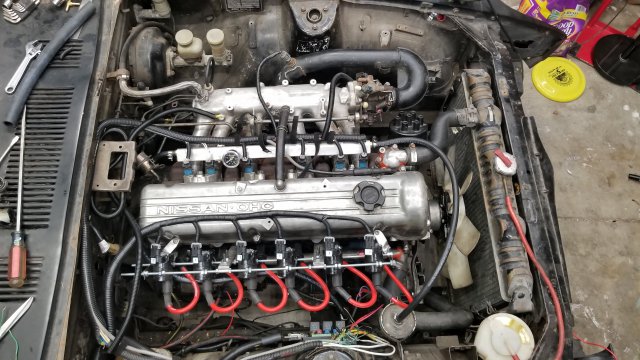

Gollum Posted September 23, 2018 Share Posted September 23, 2018 Both of the first two pics you posted are the same all aluminum intake as what the 350z had. They just also have the plastic vanity cover that makes an engine not look like a "mess" to non-car folk. If you keep an L engine then EFI doesn't mean the engine bay can't be clean. To the contrary I'd say it's easier to maintain a clean look with EFI, but you certainly need to ditch a lot of the OEM design to it. I have ZERO focus on aesthetics with my car and it looks world's cleaner than that 280zx engine bay you posted. Quote Link to comment Share on other sites More sharing options...
