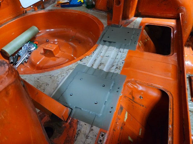

Dat73z Posted April 24 Author Share Posted April 24 Continuing on chassis reinforcements, the Nissan comp OE type rollbar will be delivered later today. The OE type rollbar bolts to the existing m10 captive nuts above the rear tubs and also to the trunk floor straddling the reinforced u-channel between the rear shock towers and rear suspension/driveline mounting points. For the floors I've started fabricating some 6"x6" 1/8" steel doubler plates which I will weld some captive nuts as they do in the JDM then stitch them in with the tig. In preparation for this, I bolted in the Escort 1 piece rear end which will stay in place for fabrication. Given the reinforced structure of the rear suspension points, I don't think things will move around but just for peace of mind that everything bolts up properly before and after welding. I've learned my lessons over the years from welding warpage and fixing my mistakes with blocks of wood and BFHs 😂 I also decided to mock up the PTZ cover one last time to verify dimensions before machining and I'm not sure how I got this so wrong but everything fits. I was under the impression that the Escort geometry was the same as OEM so maybe the T3 geometry is different. Not a big deal either way, as the front diff mount needs a bit of refabrication for the exhaust and shortening the AL driveshaft is straightforward. I also have some spare Q45 diffs I could blow apart and check for fit, but I'm running out of time and need to do some other welding and misc. chassis work before it goes on a bodycart for transport next week. Quote Link to comment Share on other sites More sharing options...

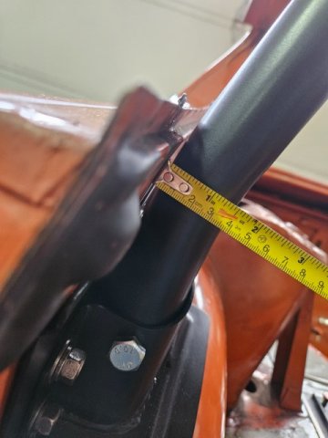

calZ Posted April 26 Share Posted April 26 The rollbar looks great. Would you mind taking a picture from below to show how close it is to the roof structure? Quote Link to comment Share on other sites More sharing options...
Dat73z Posted April 27 Author Share Posted April 27 (edited) @calZ here's some pics and rough measurements. I believe the roll bar is designed to fit around most the interior of the car, with some areas such as the interior quarter panel pieces requiring trimming around the bracketry. Also, to my understanding there were only a few of these roll bars produced and I'm not sure if or when more will be made. A quick mid-weekend update: I finished fabricating the rear deck plates by welding in captive nuts, weld through primer on all surfaces, then tacked the rear plates in. With the main hoop torqued in the plates are in perfect alignment for the fasteners to thread by finger. To be honest it was a huge pita timesink to straighten the floors where possible for tig prep, but I'm glad that's all done. A friend mentioned that in-period the plates would've probably been mig welded in, perhaps poorly with mig wire sticking out so sanitary tig dimes are probably going to look out of place 😂. Now I just need a couple of hours to take my time and stitch weld the plates then finish with some self etching primer. Edited April 27 by Dat73z Quote Link to comment Share on other sites More sharing options...
calZ Posted April 27 Share Posted April 27 Thanks! Looks like they did a really good job of getting it tucked in there. I'm tall, so I've just been assuming I'll have to go custom to get something that isn't within reach of my head. Quote Link to comment Share on other sites More sharing options...
Dat73z Posted April 27 Author Share Posted April 27 Yeah the geometry of the s30 is just difficult. I am also tall and every s30 with an off the shelf roll bar or cage (autopower 4 and 6 points come to mind) has put the main hoop at my head or had some combination of factors making the seating position awkward. I would definitely go custom. Last night I was able to mostly stitch weld everything in. Not my best work but I was getting good penetration so I'm confident it's strong. Every weld was done crazily out of position with the foot pedal on the floorboards or contorted sideways with with a leg out the door 😂. I'm really hoping I can wrap this today as I need to move back to welding in the engine bay. Quote Link to comment Share on other sites More sharing options...
