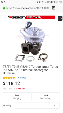

Hey everyone, so I did a thing.
I just ordered one of these turbos on Ebay over the weekend when there was a 15% discount. So it was normally $118.
The turbo is a knock-off / no-name /copy sold  by "racingpartswarehouse". Delivery expected by Jan 8th, so I'm pretty sure it's shipping from the US. (CA according to Ebay)
I've just got a stock 280ZXT turbo on my motor right now, so this will be a good upgrade and hopefully run a long time :) I'll make sure and report back once I get it and once I get it installed and running. Plan on running up to 15psi for now. I think that's about where I'll start maxing out my 440cc injectors, hoping for a decent 300-350hp or so. The specs look really good size-wise to match up with an L28. Not too small and not crazy big either. Comparable to other T3/T04s or a GT30 sized turbo with 76mm compressor exducer. I've got my fingers crossed that it all looks and works fine. I'll be verifying the specs and inspecting everything when I receive it. Any suggestions on specific things to look for?
Here are the specs as listed:
T3/T04E (Journal Bearing / Oil Cooled / Internal Wastegate / V-band exhaust)
Compressor
Inducer: 50.5mm
Exducer: 76mm
Trim: 55
A/R: 0.5
Turbine
Inducer: 65.5mm
Exducer: 55.9mm
Trim: 73
A/R: 0.63

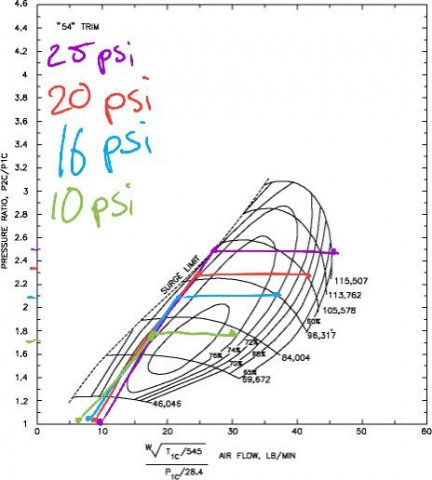

I was just playing around plotting (estimated) L28 air flow on T04E compressor maps
50 trim - 46lb/min (up to 420hp)
54 trim - 44lb/min (up to 400hp)
57 trim - 50lb/min (up to 460hp)
The Ebay turbo that I got doesn't seem to have any compressor maps available, I just figured one of these would be close to the 55 trim Ebay turbo.
