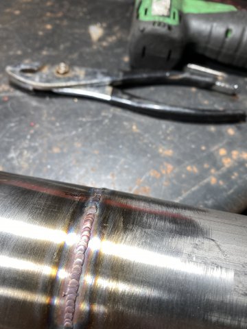

tioga Posted December 7, 2019 Author Share Posted December 7, 2019 Made some more progress on the exhaust today. Some of my welds started to look better. Some did not. Should be finished this weekend for sure. What kind of welding table do people use when the exhaust sticks out 4’ One direction and 2.5’ perpendicular to that? I suppose they can weld pretty at any angle standing on their head. I can’t. I did do all my welds today without dipping my tungsten in the weld and that was nice. . Quote Link to comment Share on other sites More sharing options...
grannyknot Posted December 7, 2019 Share Posted December 7, 2019 21 hours ago, tioga said: I did do all my welds today without dipping my tungsten in the weld and that was nice. That's not a small accomplishment! Congrats, are you purging the pipe with argon or using Solar Flux? Quote Link to comment Share on other sites More sharing options...
tioga Posted December 8, 2019 Author Share Posted December 8, 2019 Have always used solar flux. I have a second regulator and argon tank but have never used it. I am curious about the difference in weld look with argon but have never bothered to try it. Quote Link to comment Share on other sites More sharing options...
tioga Posted December 8, 2019 Author Share Posted December 8, 2019 Quote Link to comment Share on other sites More sharing options...

grannyknot Posted December 8, 2019 Share Posted December 8, 2019 8 hours ago, tioga said: I am curious about the difference in weld look with argon but have never bothered to try it. Using argon the inside weld is smoother than solar flux but not a lot. Quote Link to comment Share on other sites More sharing options...

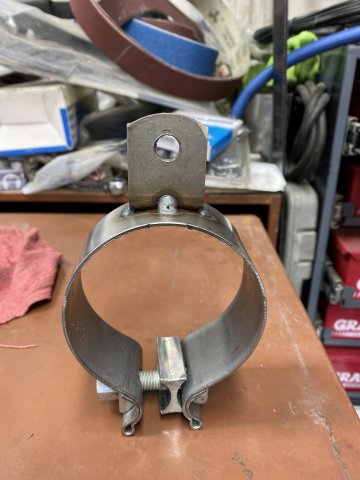

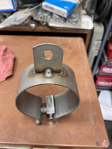

HuD 91gt Posted December 9, 2019 Share Posted December 9, 2019 (edited) I need to find myself a can of solar flux. Doing an exhaust really eats up the argon when pack purging. When i welded my exhaust I hung it with ratchet straps. It wasn’t the best setup, but you could rest some weight in the exhaust when welding. I like your exhaust clamp! Edited December 9, 2019 by HuD 91gt Quote Link to comment Share on other sites More sharing options...
