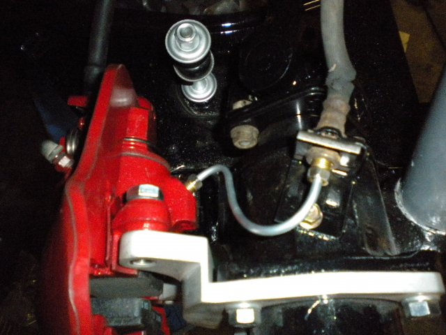

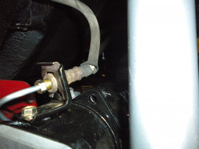

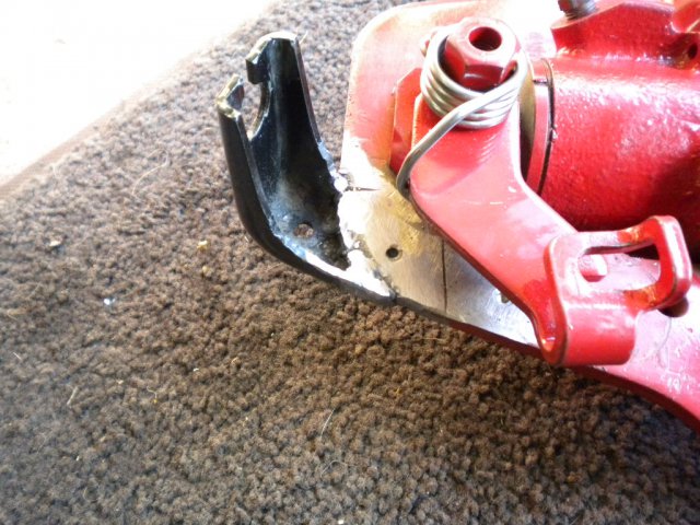

HLS30-08077 Posted November 2, 2009 Share Posted November 2, 2009 So here's my Progress so far. This is all on an early 260Z (2/74) using the 79' to 81' rear disc brake conversion brackets from JOE and 79' 280ZX rear calipers. The Ebrake mounting tab is too low and has clearance issues with the control arm. My fix is in the pics. The early 260Z's brake line mount is in direct line with the large caliper plate and will need to be removed and a new one place farther back towards the rear of the car to clear the plate. I crossed the Ebrake cables to take up the slack and they work great. I can operate them by hand, pulling the "Horse-shoe bracket in front of the diff. Now I gotta change the brake line bracket to clear the caliper plate. Then order the Stainless brake lines to mock up the hard line from the calipers. Dave Link to comment Share on other sites More sharing options...
HLS30-08077 Posted November 3, 2009 Share Posted November 3, 2009 So I bought a brake line with ends on it and started bending. Foound some of the OE brackets and tried this out...... Below. Also ordered my Stainless Steel Brake lines and clutch line. Should be here by thursday, so I can see if the mod will work with full suspension travel. Cause this WILL be a driver, not some show peice, taking up space in some dark garage. I hate that. Oh Ya, I used the old ratty line for mock up but it's out of here on thursday. I'm thinking maybe a long soft spring for any hang over issues, similar to the ebrake line over the diff. Link to comment Share on other sites More sharing options...
