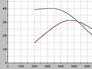

BillZ260 Posted January 8, 2006 Author Share Posted January 8, 2006 Tired of wondering what I'll be running with my set up so I thought I would post up what my combo will be putting down....(From DD2002) Looks like it will have plenty of low end torque for the street I still have to make a decision on pistons and compression. The KB's that came with it werer standard bore . I'll take any suggestions you all have into consideration as far as style and brand. Specs: 355 (.03 overbore) chevy Alum Edelbrock Performer Heads w/ 2.02/1.6 valves Edelbrock Performer 400 Cam .442 lift / 214 Deg Duration Pistons/Compression????? -- Here I used 9.0 Shorty Square port headers, 2.5" exhaust w/ Dynomax Curve: Quote Link to comment Share on other sites More sharing options...

grumpyvette Posted February 27, 2006 Share Posted February 27, 2006 "Specs: 355 (.03 overbore) chevy Alum Edelbrock Performer Heads w/ 2.02/1.6 valves Edelbrock Performer 400 Cam .442 lift / 214 Deg Duration Pistons/Compression????? -- Here I used 9.0 Shorty Square port headers, 2.5" exhaust w/ Dynomax BillZ260 why not boost the compression ratio to 10.5:1 and swap the cam to a crane 114681, I think youll notice a marked differance in results " http://www.cranecams.com/?show=browseParts&action=partSpec&partNumber=114681&lvl=2&prt=5 Quote Link to comment Share on other sites More sharing options...
dr_hunt Posted February 27, 2006 Share Posted February 27, 2006 I've used that cam before, sounds real tough, and makes good power, the 10.5 would be a must and should work good if your using a 4-5 speed trans. Quote Link to comment Share on other sites More sharing options...
