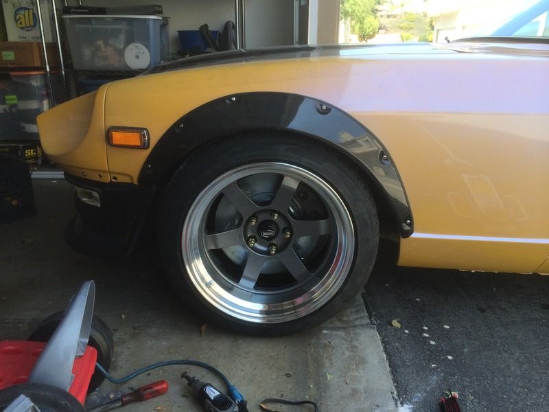

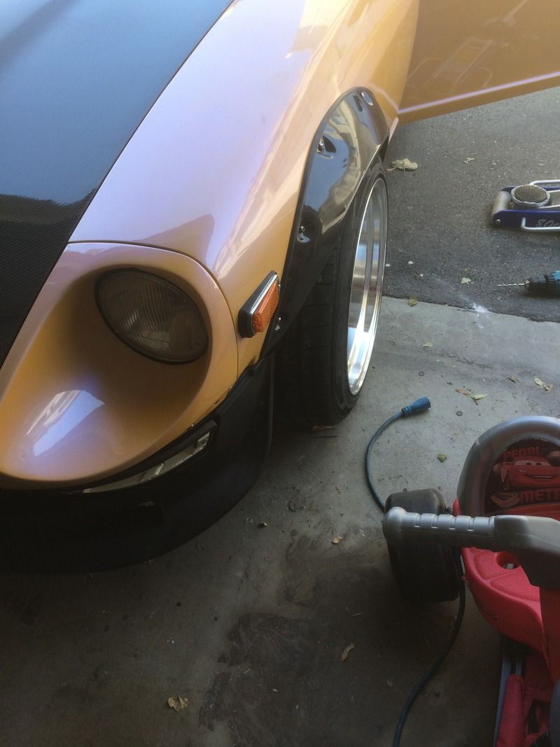

S30 SPL Posted May 7, 2015 Share Posted May 7, 2015 I just got a set of those in carbon from jdmflares.com and they are ok. I wouldn't call them show quality carbon, but they are very good for the money I think. Now my problem is that I'm not sure how to install them because if I just lay them against the body, they don't seem to fit the fender line in the front very well. Is it normal to have to bow them together to align with the fender ends? Anyone have close up images of where your flares start and end? Perhaps some measurements? Link to comment Share on other sites More sharing options...

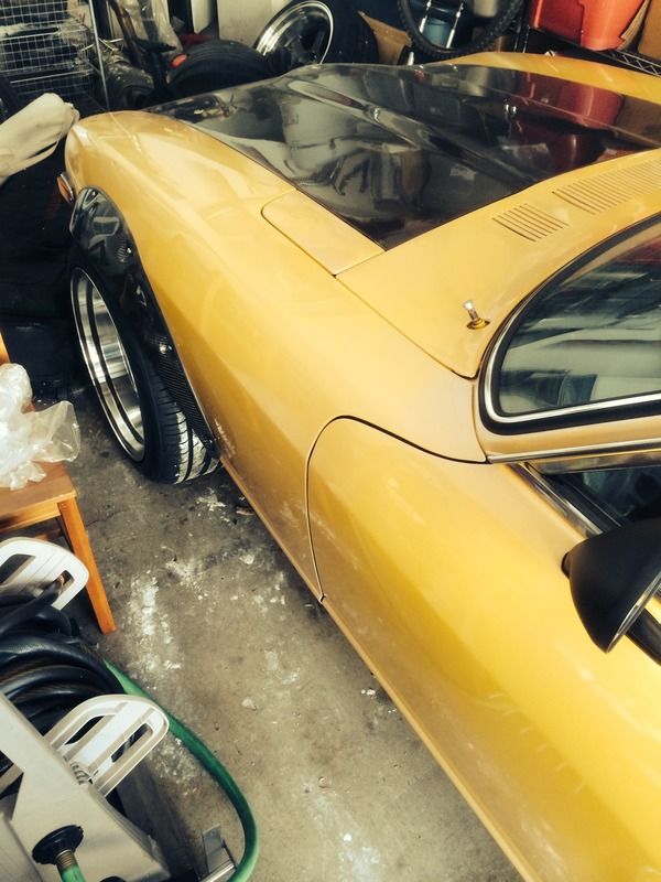

S30 SPL Posted May 13, 2015 Share Posted May 13, 2015 (edited) No doubt those are very nice quality, but they are fiberglass. I really wanted carbon to go with the other carbon stuff I have going on. Here's a glimpse of what it looks like: Edited May 13, 2015 by S30 SPL Link to comment Share on other sites More sharing options...
Sovereign Z Posted May 13, 2015 Share Posted May 13, 2015 hmm seems better to hydro-dip the good fiberglass ones to a carbonfiber look or have them wrapped and leave the shoddy fitting ones alone. to answer your question, yes some have had to bend them a little to make them fit. Link to comment Share on other sites More sharing options...
S30 SPL Posted May 13, 2015 Share Posted May 13, 2015 hmm seems better to hydro-dip the good fiberglass ones to a carbonfiber look or have them wrapped and leave the shoddy fitting ones alone. to answer your question, yes some have had to bend them a little to make them fit. Good to know that some bend is normal. I didn't have to force anything to have it fit, but curious more than anything since I've only worked on my own car and this particular vendor. Thank you for that!! Is what I have ill fitting in your opinion? I think hydrodipping is very cool, but I am not a fan of "imitation" materials if I can help it. Black paint would work just fine if I did go the FRP route though. Link to comment Share on other sites More sharing options...
