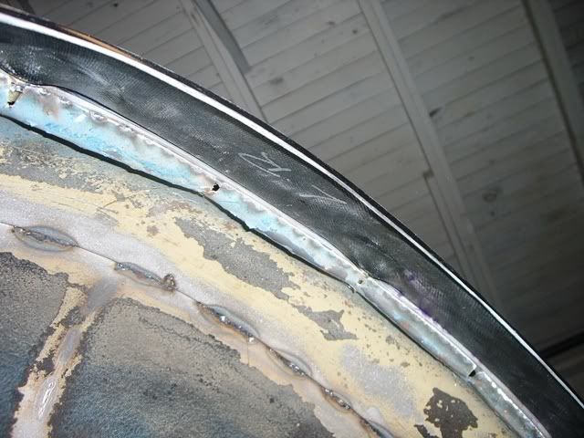

johnc Posted August 4, 2006 Share Posted August 4, 2006 I'm pretty sure the rear flare on that car is on the wrong side. I thought it was rotated forward a bit too much. When the body shop re-did things the flare sat much better on the car. Link to comment Share on other sites More sharing options...

240hoke Posted August 5, 2006 Author Share Posted August 5, 2006 toecutter -- After looking at those pictures closely I think you are right, my flares were fatter in the front and tapered in a little towards the rear. Looks like he might have them flip flopped, but its kinda hard to say from those pictures. gav240z -- If your car is as low as mine and you are running wide tires I reccomend you cut them a little farther up like johnc, perhaps .5" to 1" farther in the rear. I may be cutting up a little farther in the future for safe measures. And Yes I am still doing the kits: They are 55 dollars plus 5 bucks shipping. It includes: 24+1 SS 1/4" allen button head bolts 24+1 SS 1/4" AN style washers (smaller diameter) 12+1 Nutserts for the rear 12+1 SS nuts/lock washer/washers for the front 4 Strips of welting - this is nice quality stuff, i loved using it on my car, very flexible and easy to work with. Pm me if you are interested. Thanks! Link to comment Share on other sites More sharing options...

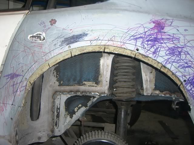

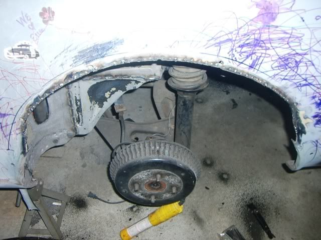

rudypoochris Posted August 11, 2006 Share Posted August 11, 2006 I was wondering, if you were to cut the outer rear fender, instead of bending the inner fender back up and tacking, would it be possible just to clamp it flat against the outerfender? This way it would become the same layer as the outerfender and you would bolt through both when you installed the flares (avoiding nut insert thingamajigers). That would allow you not to have to weld, and then you could just use epoxy or something similar to seal it up nicely. The question though, is, is there enough metal? just a thought. Link to comment Share on other sites More sharing options...
240hoke Posted August 16, 2006 Author Share Posted August 16, 2006 No I dont think its possible, if you looks at the design of the inner fender it cant very well be pinched together, especially if you cut it up higher like johnc. I tink youll end up warping hte fender and it would also leave a sharp edge. But who knows give it a try and let us know! Link to comment Share on other sites More sharing options...

bjhines Posted September 18, 2006 Share Posted September 18, 2006 I went with putting the tops of the rear flares 3.75" up from the original lips... I hope this works out fine for 2" shorter struts with 16x10" wheels... I fit the fronts similarly... though they do not seem to need as much cutting I added a few more pics... ... ... Link to comment Share on other sites More sharing options...
