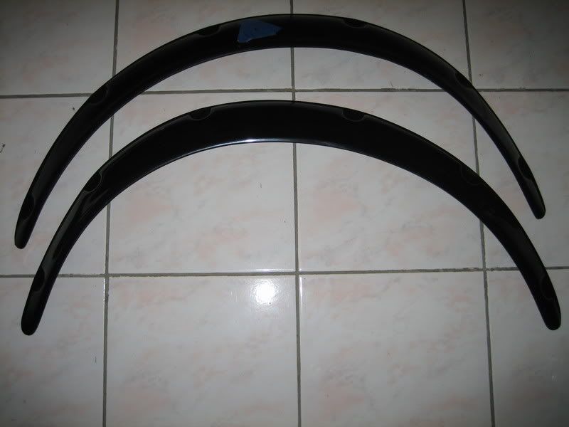

Thanh Posted April 10, 2007 Share Posted April 10, 2007 Hopefully someone can answer this ASAP. In the process of installing Zg flares. Today I tested the flares on today to see if they were in good shape so I can start measuring and cutting. I came across two flares that fitted really good and two flares that just left huge gaps everywhere when we tried to hold it in a mounting position. The body is pretty straight so I know for a fact it wasn't the body. My friend the body man told me to take them back for an exchanged. So we had a good passenger front flare and driver's rear. Returning the drivers front and passengers rear. I purchase this from MSA about 2 months ago. Took it in to them and they had no problem with exchanging the two. Then the guy told me that I might have mounted wrong. He said " The two wider flares are suppose to be in the front and the thin in the rear". Now I need some serious opinions on what should be the proper way to do this. I never thought that it would be Wider in the front and thinner in the back? Is he wrong? Heres a picture of the flares. I need to test fit the two I exchanged to see how they fit. I would greatly appreciated if someone can reply to this as soon as possible. What I assume is the front flares Thin ones. Blue marks perfect fit. Unmark means Exchanged What I assume is the rear flares wider one. Blue marks perfect fit. Unmark means exchanged -Thanh Link to comment Share on other sites More sharing options...
toecutter Posted April 11, 2007 Share Posted April 11, 2007 I'm pretty sure the wide ones go at the back. Be sure to get the two rear ones on the correct side. Just look side on and you'll notice the difference. The "fatter" part needs to face forward, very easy to confuse if you don' t look carefully as I mounted them opposite the first time. I'm pretty sure the pics below show em mounted the wrong way round, its been a while but you have to put them on and look very closely. Link to comment Share on other sites More sharing options...
