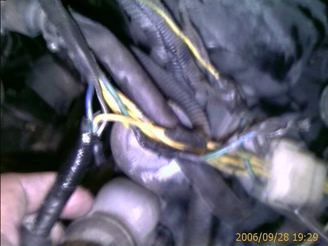

jtmny1999 Posted September 29, 2006 Share Posted September 29, 2006 gratz here is a quick pic i took for coil wiring Quote Link to comment Share on other sites More sharing options...
AE2ZX Posted September 29, 2006 Author Share Posted September 29, 2006 thanks man ... on the little box next to the coil .. i had that black and white striped wire pluged into the resitor on there then grounded that resitor was ran to the na harnees .... it was wrong .. it would blow my fuel pump realy fuseable link everytime i turned the key on ..after it shorted out that ground i figured it out .wierd the na car harness is just a little differnty setup .... ya something up with vac stuff . i tryed hooking and unhooking the turbo vac valves box .No change . i think she aprking right for sure and the injectors are fireing right for sure .i turned the timeing back to 10 deg off top dead .using a timing lite . Quote Link to comment Share on other sites More sharing options...
trippintl0 Posted September 29, 2006 Share Posted September 29, 2006 two of those extra wires to the transmission are probably the neutral/park start switch. It is a switch that is only grounded when the automatic tranny is in park or neutral. Since you have a manual, these two wires can be permanently connected together. (or if you mess with inhibitor relay, like you said, that probably took care of it, too!) looking good btw Quote Link to comment Share on other sites More sharing options...

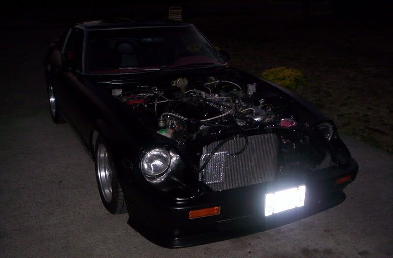

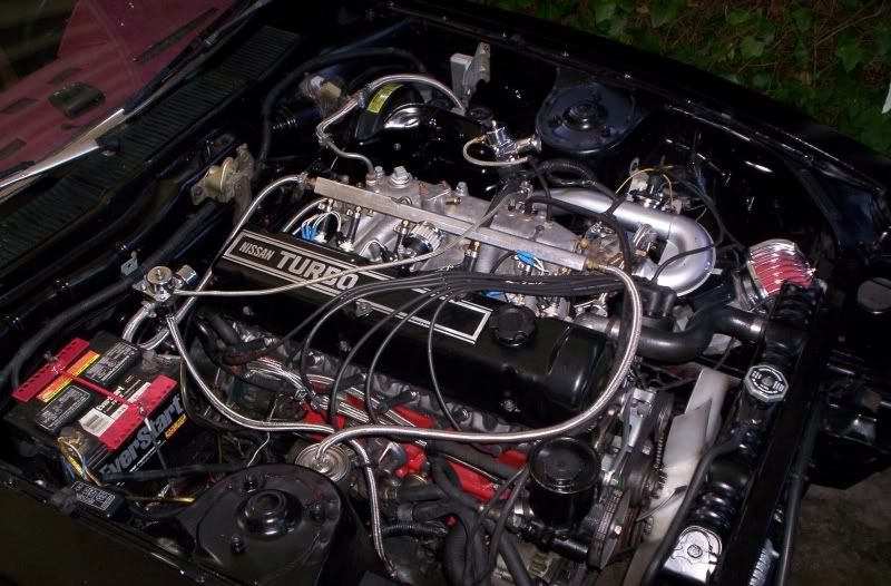

BleachZee Posted September 29, 2006 Share Posted September 29, 2006 oh ya, your engine looks real nice. Good engine compartment too. Well, I had a known bad turbo AFM and I swapped it on one time to see what it did. It had a slight stumble and at idle and then wouldn't rev past about 2200 rpm. Maybe you should dissasemble the AFM and carefully clean off the front and back of all the boards inside. I don't think the TPS is a problem in this case... I mean, just make sure the connector is clean and dry but I'm sure it already is. Fuel pressure should be 32 at idle. Quote Link to comment Share on other sites More sharing options...

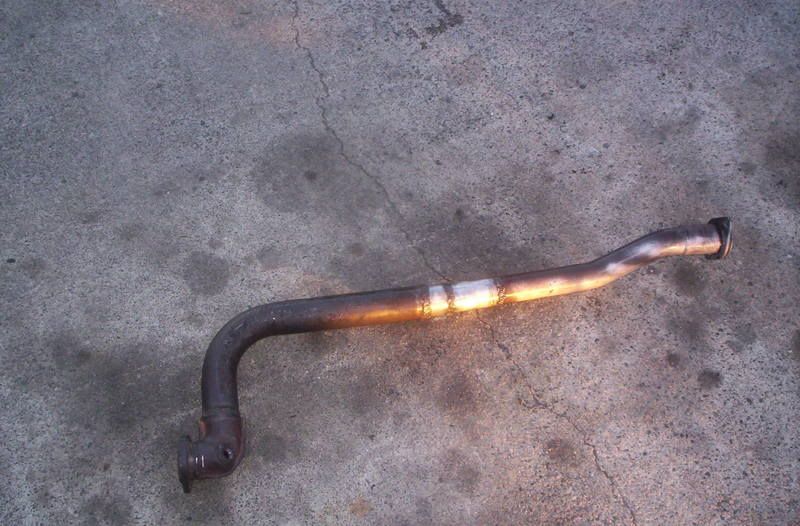

AE2ZX Posted October 3, 2006 Author Share Posted October 3, 2006 Thanks B Tryed to weld up a spot nere my test pipe ..i think iam going to weld and new piece in there and get rid of the leaky test pipe crapper turned the afm screw out more and it does seem better . also swaped Tps sensors ..i think it was better ....... than the one that i took off was really old looking on the back side . tryed to tighten my ex manifold bolts but burnt my hand ..going to come back to that one when she's cold.......... seems like i have a little leak on one or two off the manifold blots ...not sure witch one mabe #three Quote Link to comment Share on other sites More sharing options...
