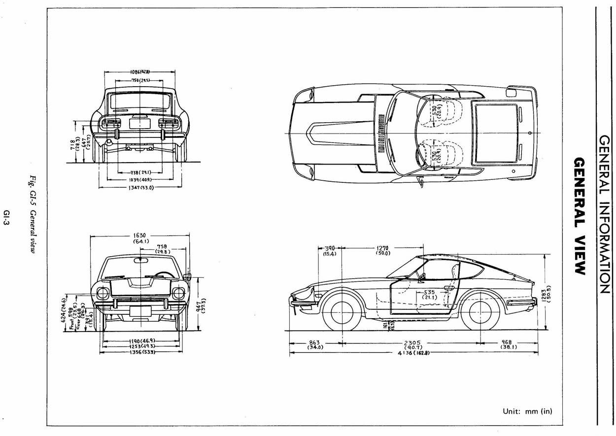

Here's a pic I found on the internet with stock wheels
The rear wheel sits forward a little, but it doesn't look like it has as much space between the tire and the back of the wheel opening. As you can see the front wheel looks farther forward than in your pic as well.
